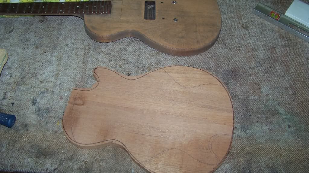

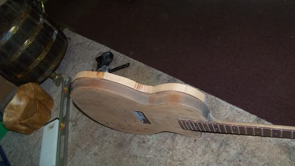

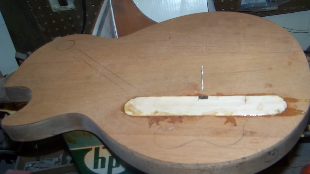

Postby oipunkguy » Tue Nov 13, 2012 11:39 pm
i usually dont like to let soo much excess glue dry on the wood but i was in a hurry at the time. i still should have wiped off the excess, just made more work for myself later on. let that be a lesson to you guys! lol.

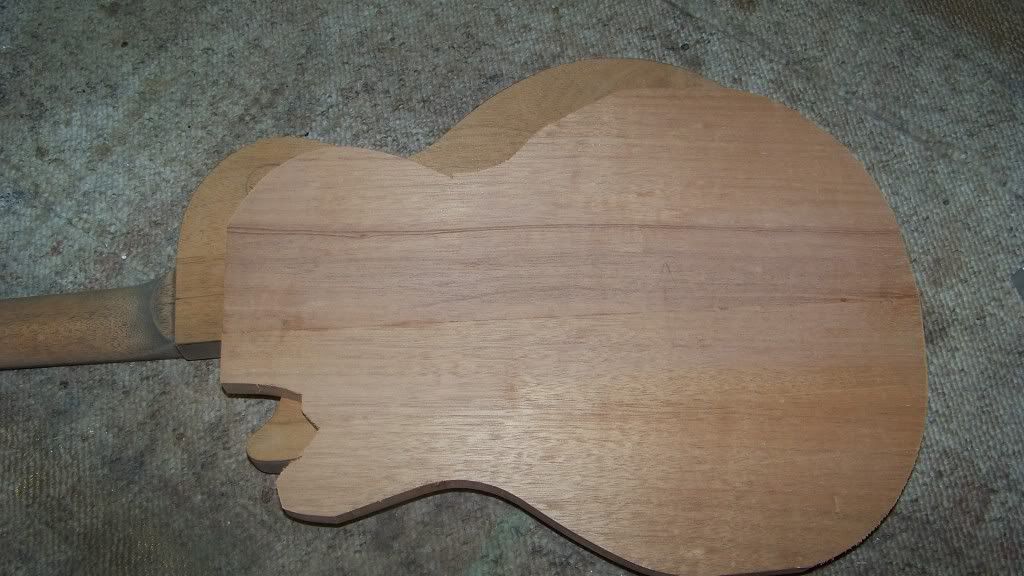

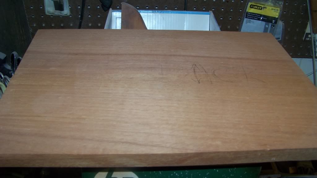

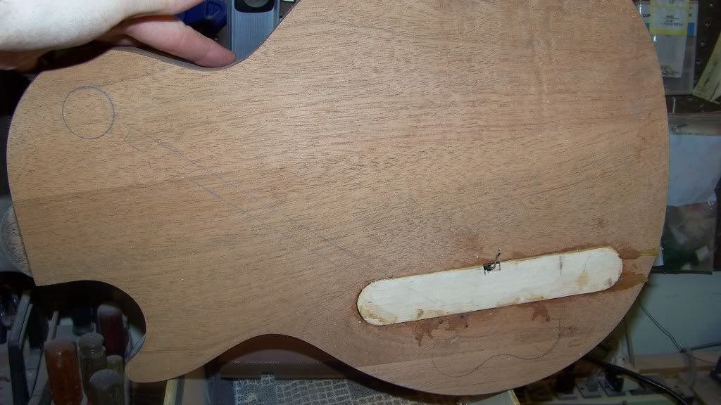

Postby oipunkguy » Tue Nov 13, 2012 11:43 pm
new mahagony for the back of the LP

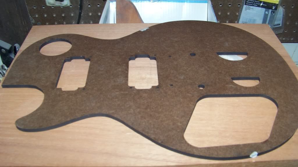

Postby oipunkguy » Tue Nov 13, 2012 11:46 pm
lp template

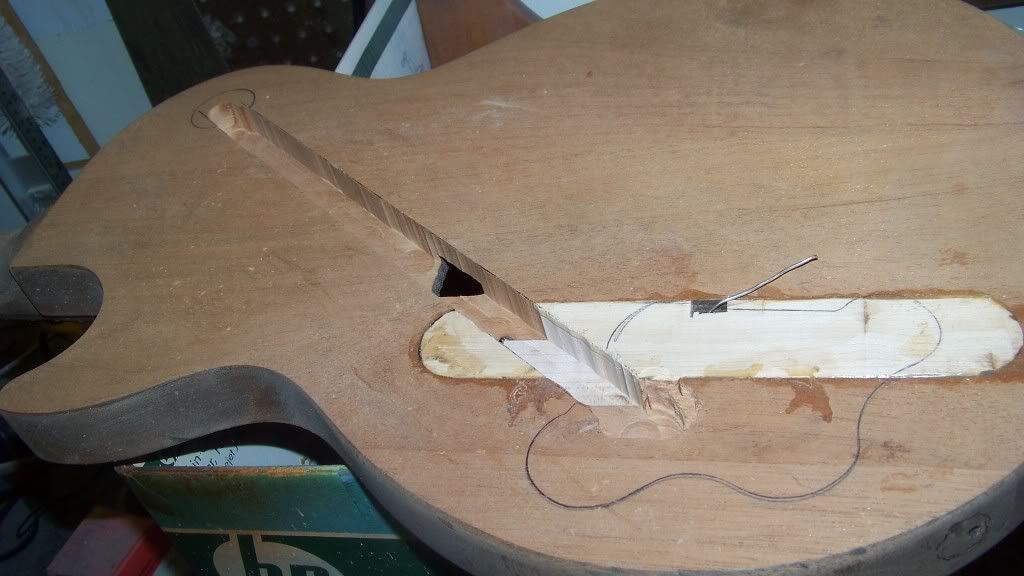

Postby oipunkguy » Tue Nov 13, 2012 11:48 pm
routed out wiring channel.

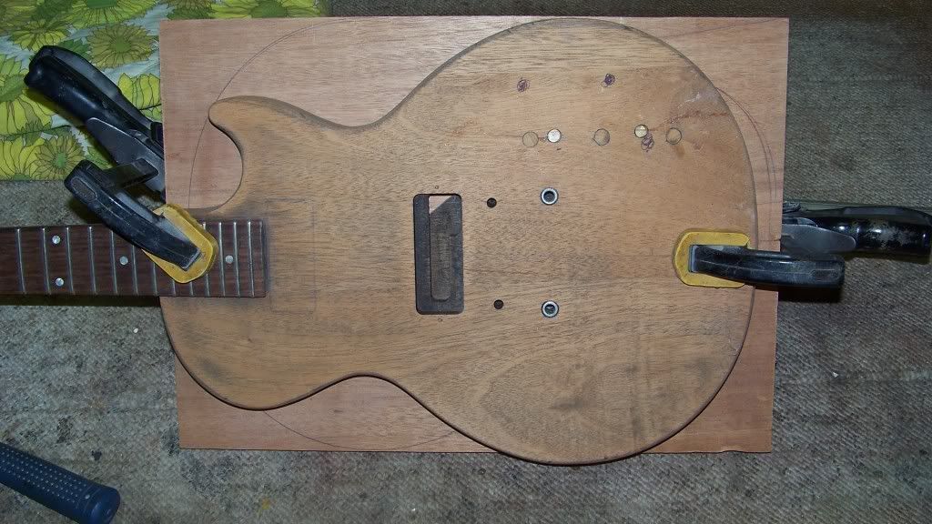

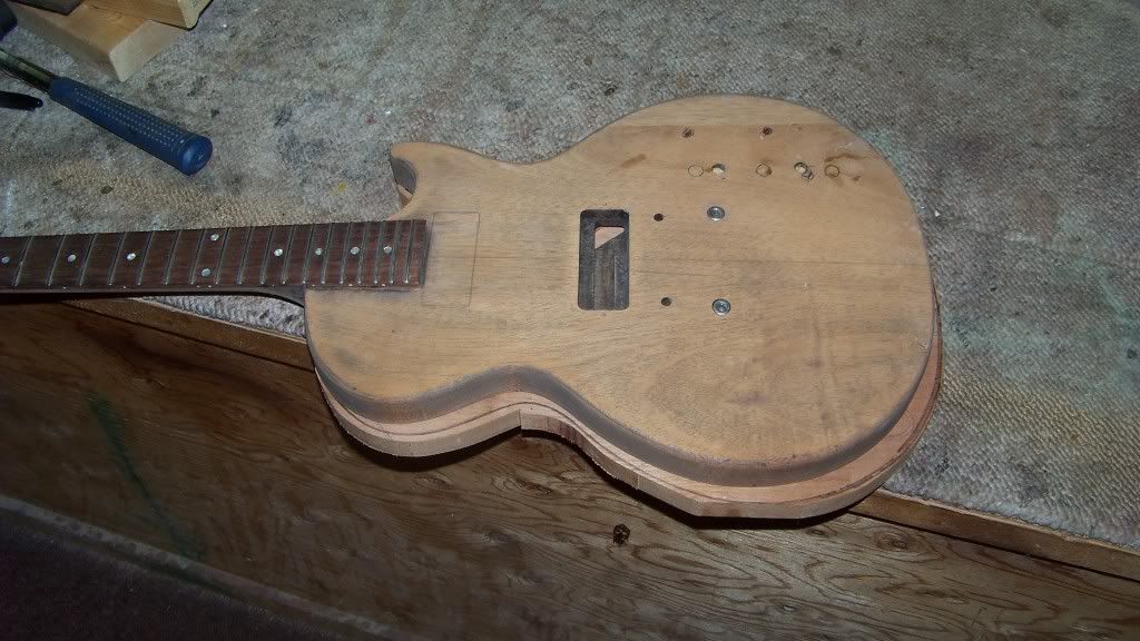

Postby oipunkguy » Thu Dec 06, 2012 12:10 am
using the body of the guitar, I did a rough outline of what I needed to cut out.

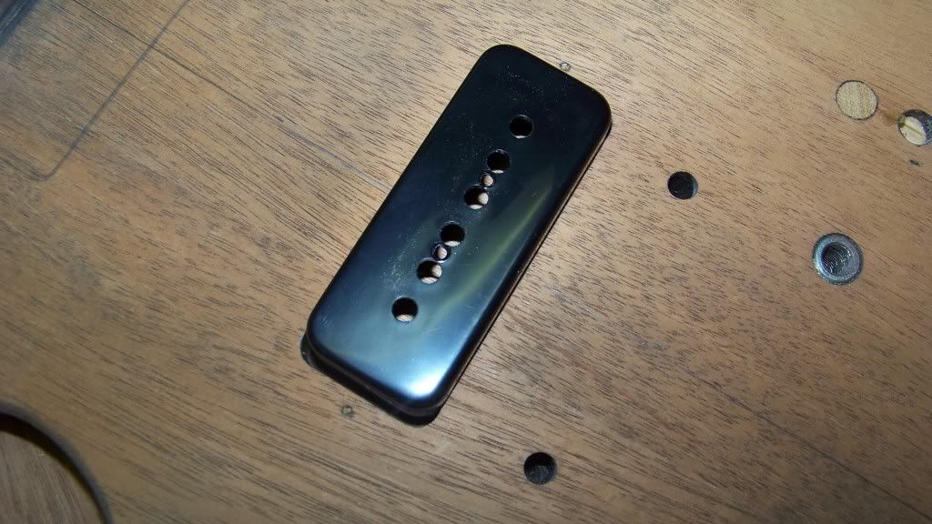

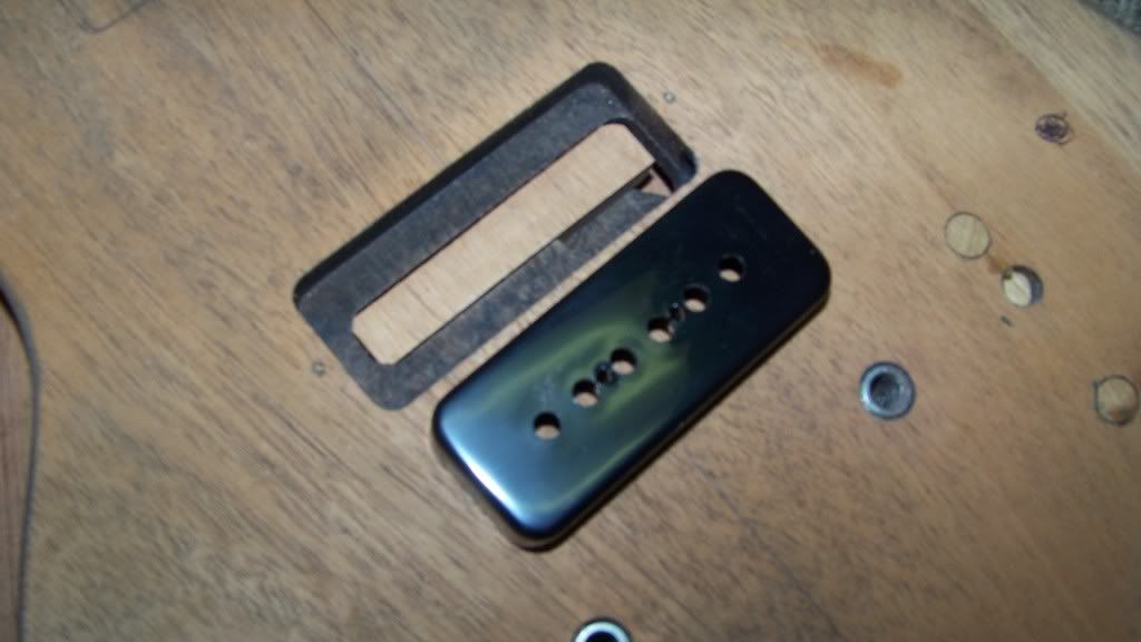

Postby oipunkguy » Thu Dec 06, 2012 12:19 am

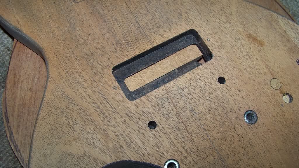

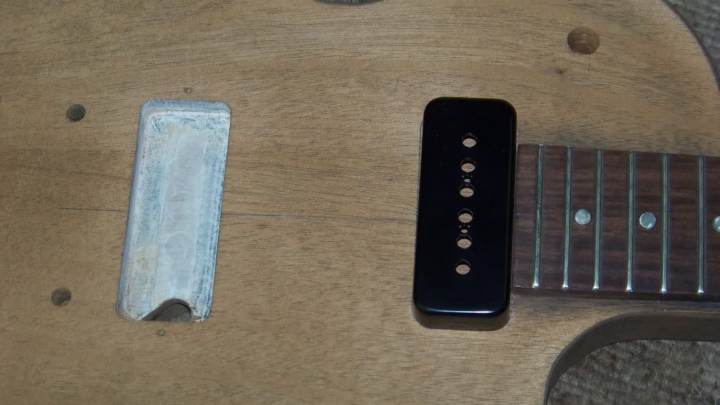

the next little challenge was modding the pickup route for the p-90. the dogear type route is slightly wider, and the regular p-90's have a more rounded corner. plus the mounting is completely different on the standard p-90 with means I had to put in filler wood and reroute the cavity.

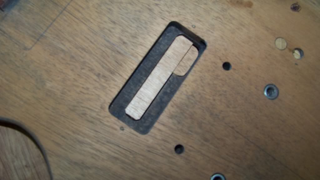

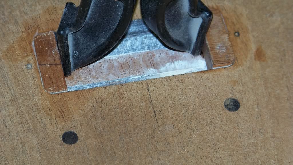

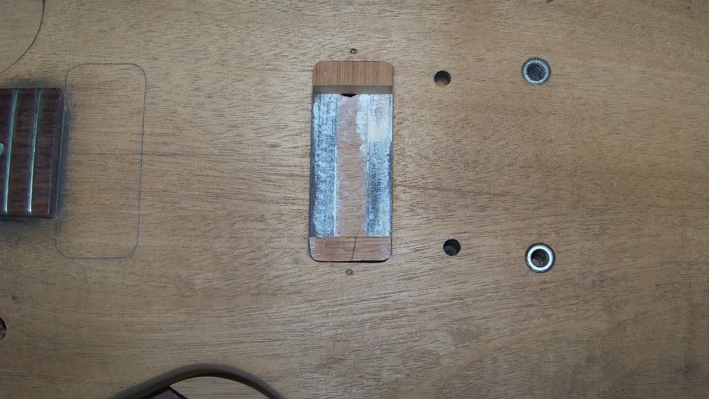

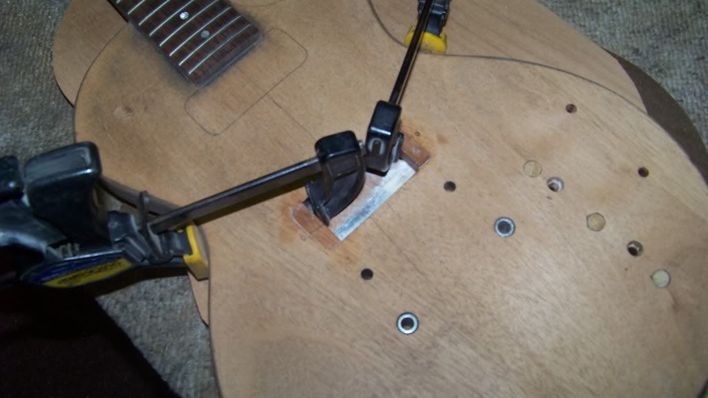

Postby oipunkguy » Thu Dec 06, 2012 12:26 am
after gluing in these mahagony inserts, i was ready to glue on the edge piece so I can reroute the corners correctly.
