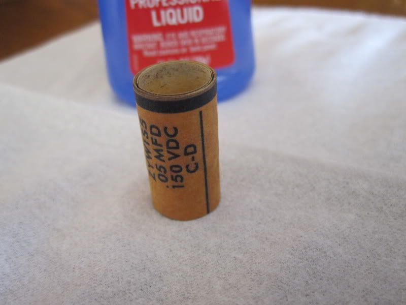

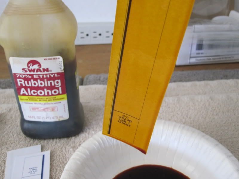

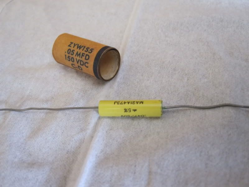

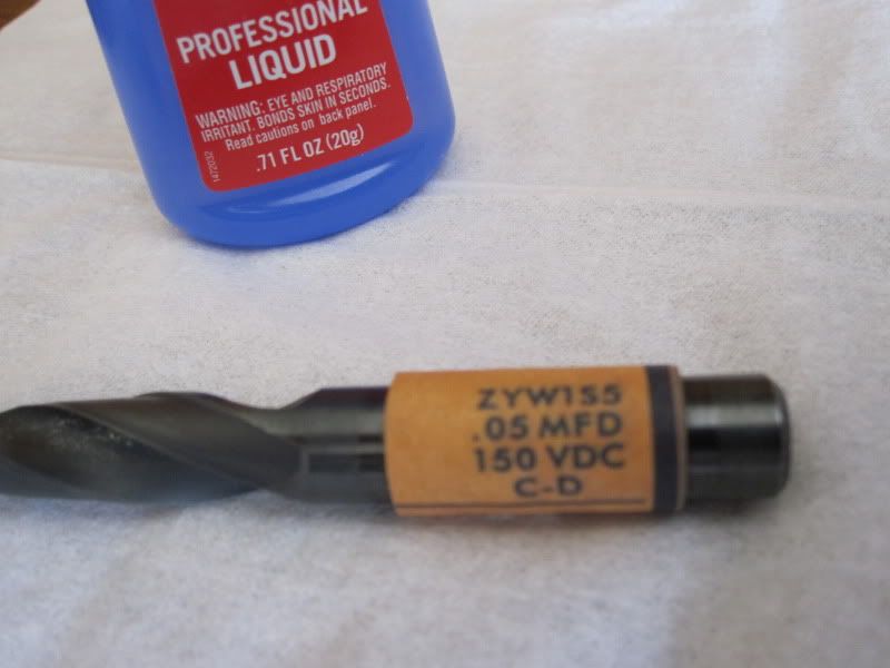

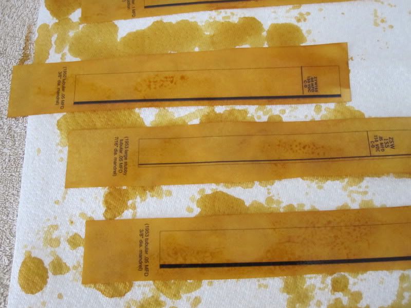

In making the faux capacitor, I printed the pattern from the link in my previous post and cut them into strips. I placed a few drops of oil based leather dye in in rubbing alcohol to make a dye bath to get the color I wanted for the replica capacitor. Next I let it dry then trim and form the strips around an 3/8" drill bit used as a mandrill to prepare it for inserting the modern capacitor and pouring in the wax.

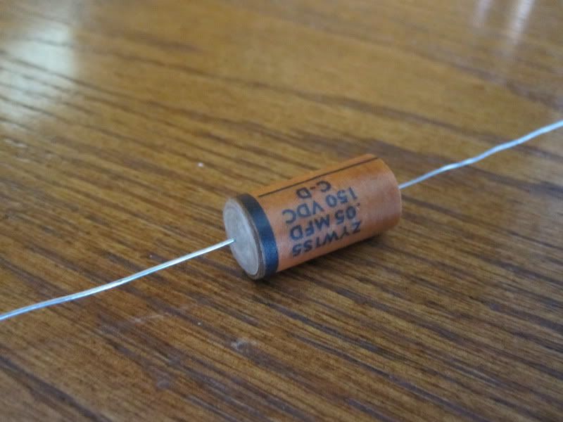

Next step will be to make up a cardboard jig to hole the capacitor center of the outer case and pour in in melted wax.

Well, here it is finished but I'm not happy with the color of the wax. I'll have to make up another one and use beeswax instead of parafin.
