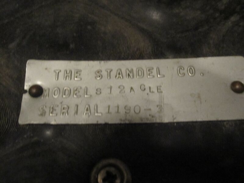

Acting on a hot tip from DorkRockRecords, I was able to pick up this Standel speaker cabinet this evening for free. It's in pretty rough shape, but interesting. I know very little about Standel amps; maybe someone here can shed some light on what this is?

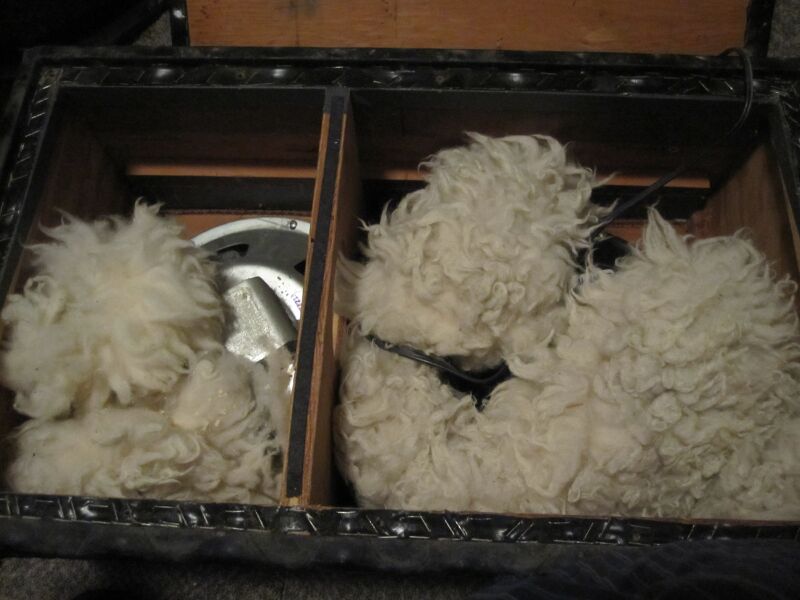

Here's what I know: the model number is S12ACLE. It's currently housing two twelve inch speakers, but I think the original configuration might have been a single twelve with a big rectangular port. Speakers are a Cerwin Vega 123ER and some mystery speaker stamped 527 677213.

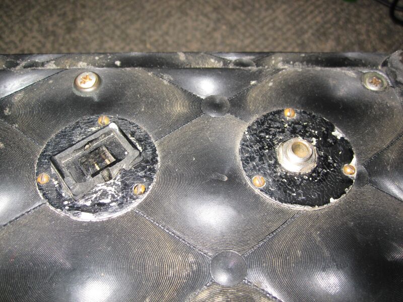

This poor thing has seen some better times. I haven't been able to test it out as the input jack is bad - I read 4 ohms across the inside but get no signal through a cable. I plan to fix that tomorrow.
Personally I love the "insulation" inside the cabinet. Is the covering possibly original? Besides the handle and the head clasps, what other hardware is missing?

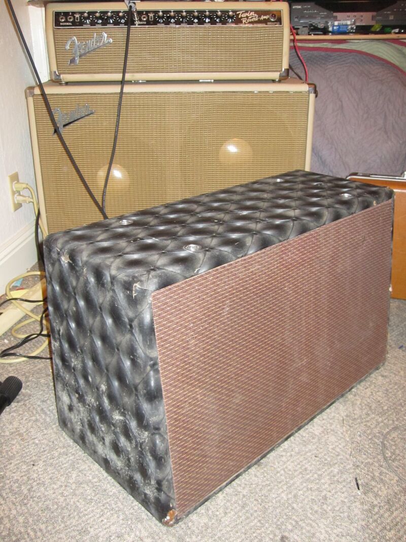

Postby Mr. Bill » Tue Sep 29, 2009 12:18 pm
That really looks cool! It would look better with a black grill.
The mystery speaker is an Eminence (EIA code 67) made during the 13th week of 1972.
Date code 677213.
I've never seen a Standel covered with that vinyl before.
