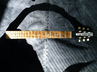

Then I found this neck;

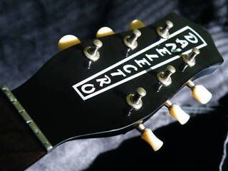

It's got the Coke bottle headstock that I like way more than the goofy new style heads.

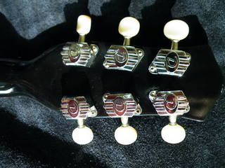

Some nice D-stamped tuners!
I figured a Dano wouldn't be real hard to make, and since I won the auction for the neck, seller included some other nice Dano stuff too, why not give building one from (kinda half-way) scratch?

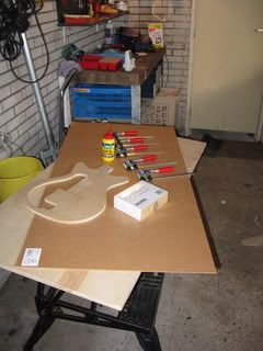

Oigun was nice enough to copy one of his Danos to make a routing template for me, which helps a LOT!
There you have it. The GUN made template, a piece of 18mm plywood (birch! don't use the hardwood stuff Oi says, that'll get you in trouble when routing the second or third channel), a piece of 4mm MDF, which is basically the same as Masonite which is used on Danos. A bunch of clamps, box set of router bits, bottle of run-of-the-mill wood glue. All in all €75/$100. I own a circular saw, a coping saw, a router, powerdrills, a B&D workbench or two, cleaned out the garage, let's get cracking!

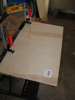

Pencil traced the template on the 18mm plywood. You might have to lean in to see the lines, they're there for sure!

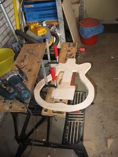

I need another skeleton cut to get to 36mm thickness

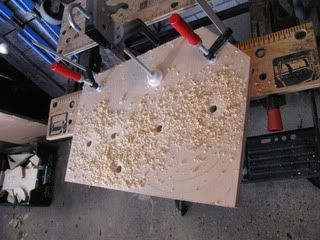

Drilled some holes to allow for easier turns with the coping saw.

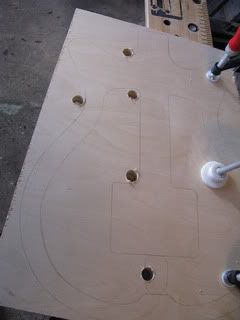

Clean what you're working on regularly
Outlines show way better in this pic.
