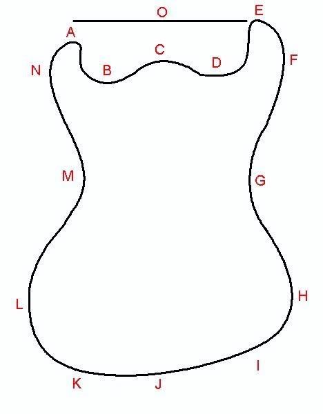

Danny;
I know this may be asking too much, but if you could kindly supply the following dimensions so I could attempt to make a body, it would be greatly appreciated and maybe even help others.
What I need for now are the following......
1- N to F
2- L to H
3- A to K Straight Down
4- E to I Straight Down
5- M to G
6- C to J
7- O to J
8- A to E Straight across
Any other dimensions you might have time to add. The more the merrier.
I hope this is not asking too much.

Re: DubTrub I need your assistance PLEASE.
Postby dubtrub » Fri May 13, 2011 1:00 pm
Woops! Pardon me! :oops:
1- N to F, 11 5/8"
2- L to H, 14"
3- A to K Straight Down, 17 3/4"
4- E to I Straight Down, 17 1/2"
5- M to G, 8 1/2"
6- C to J, 15 5/8"
7- O to J, 19"
8- A to E Straight across, 8" measuring to the inside of the opening, or 9" to the center edge of each horn.
Postby dubtrub » Fri May 13, 2011 2:28 pm
Well, while we're at it might as well get a couple more measurements for the center line. Also, I corrected some of the measurements posted before as I took them from a guitar so they were not exact. I went out to the shop and measured the template for the corrected measurements.
1. L to H, 7 1/2" from top edge to center line and 6 1/2' from center line to bottom edge. It's a bulbous shape not symmetrical.
2. N to F. 5 1/2" from top edge to cnter line and 6 1/8" from center line to bottm edge.
