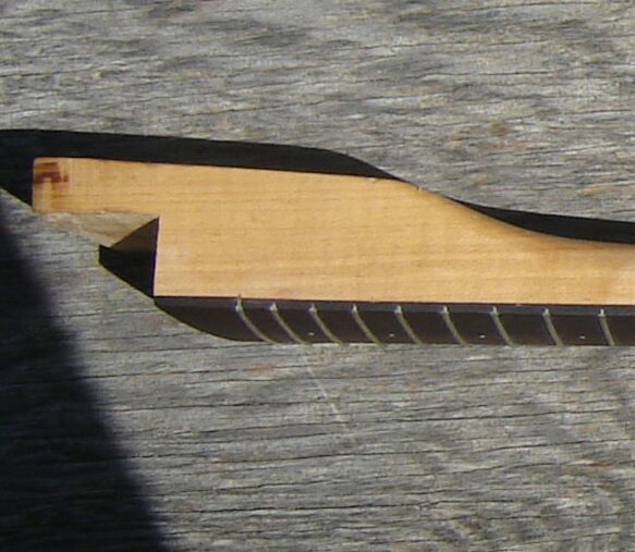

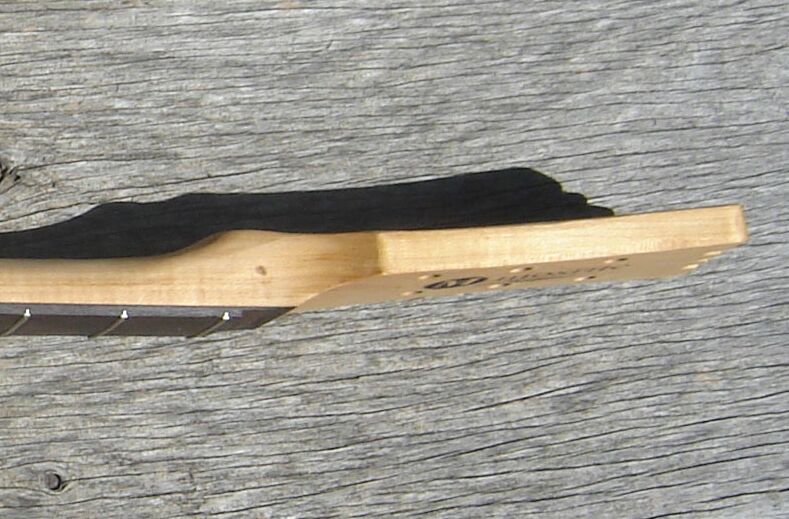

Here're some pictures of my parts-rite neck before I did the shaping and profile. You can clearly see that the base of the heel is angled compared to the plane of the fretboard. You can also see the headstock angle and scoop, as well as the volute. While this neck is from near the end of the Mosrite production run in the 90s, it has the same basic features as the 60s models.
Fender necks, by comparison, have a heel that is parallel to the fretboard, so you need to install shims to get any neck angle. I've had to do this to my Jaguars and Jazzmaster to make the mutes work.
