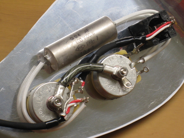

Hi vjf1968,
I don't know this is good to you or not, I did the MOD to the 60Custom especially against a noise. As you know, the normal shielding cable is not good so much. You had better replace with more better one like the image. The cable bridged between two pots is made by Audiotechnica, to avoid the voltage difference at ground level. In general, it is important to separate signal ground from body ground. You had better reduce the contact point between them as possible as you can. The two ground line should be connected around the output jack( although I didn't do so in the image).
Re: Looking for answers....
Postby Veenture » Mon Dec 14, 2009 3:49 am
arpsum wrote:The two ground line should be connected around the output jack( although I didn't do so in the image).
My computer did not show Arpsum’s image. I used the pic’s properties to gain access to the picture on internet and utilised my Photobucket account to post it here for those who couldn’t see it either on Arpsum’s post. Voila:

Hi Veenture, what a kind man you are! I also recognized the photo problem, but I couldn't find what was wrong. Thanks again! arpsum
