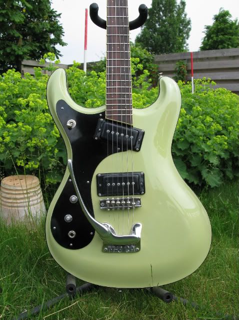

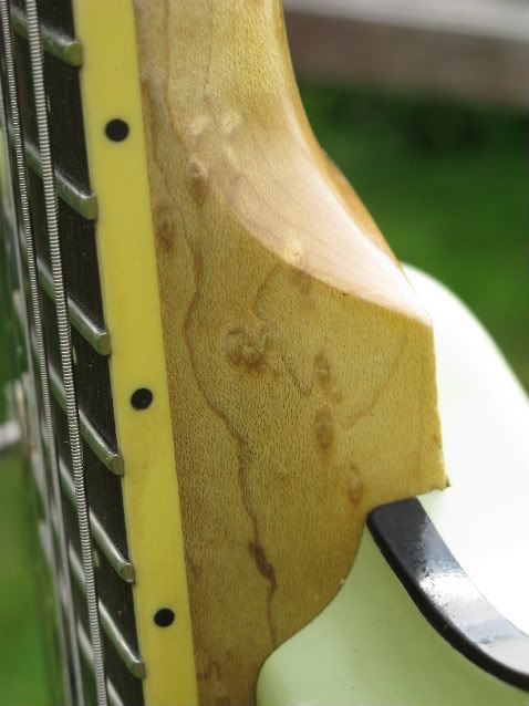

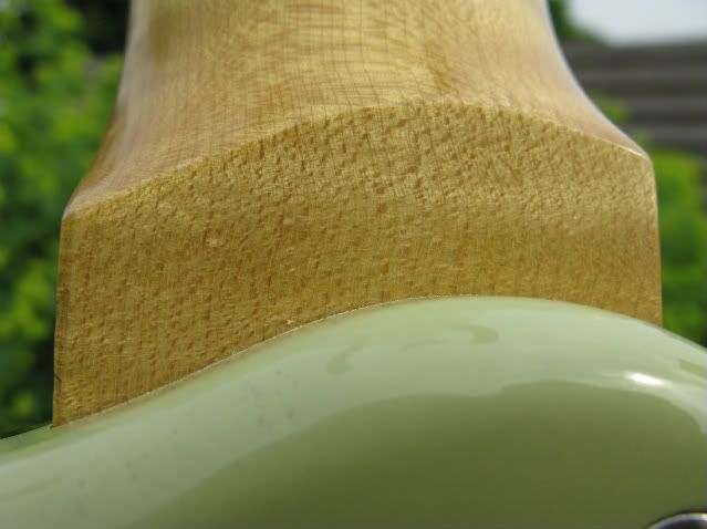

specs;
2 pc alder black bound body
quartersawn maple neck
pau ferro cream bound fingerboard
22 frets
kluson 3x3 vintage style platemounted tuners
CTS 500k lefty audiotaper pots
PIO cap
bakelite pickguard
M3 RH100 10+K pups
M3 sandcast aluminum vibrato
pretty much generic rollerbridge
10-46 strings

Re: lefty
Plays like nothing else. In a good way.
I'm so glad we went with alder for the body, it sings and it growls all at the same time.
The RH100 pups by M3 are LOUD! They have punch and they pick up on the sustain in this thing.
Sustain? This has as much as my LP junior and that's a m-o-n-s-t-e-r!

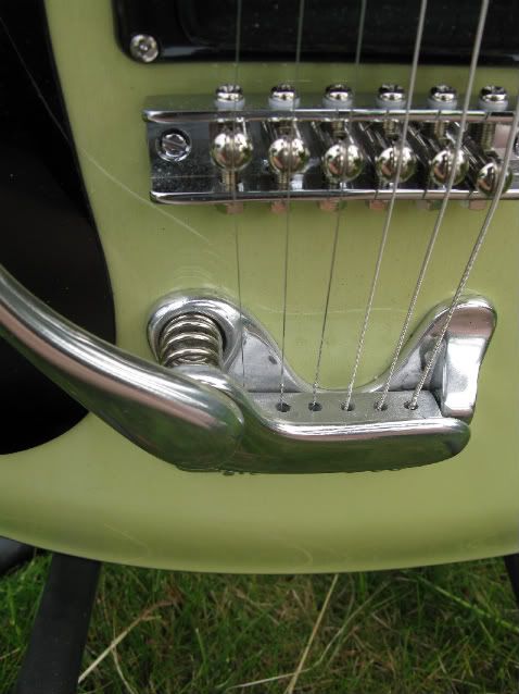

M3 vibrato does divebombs and comes back into tune, no problem. Only thing is I already broke a high E string. Broke off the ball, so even before the winding.
Maybe a sharp edge in the stringanchor. I replaced the D'Addario Oigun set it up with with 7ender Super Bullets 10-46.
Not impressed with the kinda generic roller bridge I bought, it has the typical buzz you hear about from JazzMaster owners, I might go to a Mastery bridge.
I'm trying to get a recording that sounds half way decent, but my digicam can't handle the tones from the amp. Not like too loud, just sounds awful. (the recordings! jeez...
) Doesn't do the guitar justice, you'll just have to be patient a little longer till I can get something set up for my laptop.
Amazing guitar, I'm proud to own it. Thanks Oi! U DA MAN!

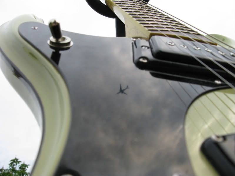

It looks great. The jet reflection in the pickguard is pretty cool too!

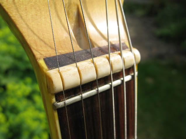

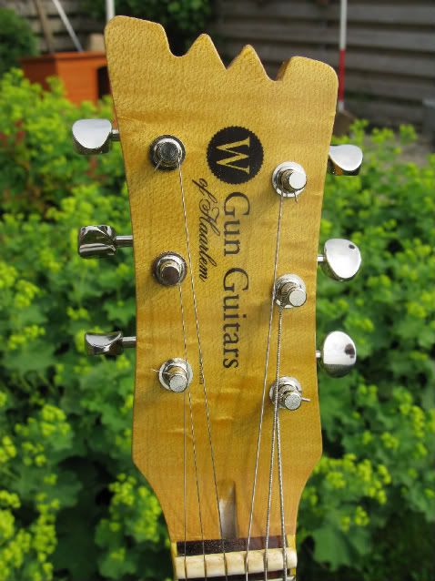

Sarah already mentioned the jet reflection so I'll pop another question:
perhaps it has been mentioned already but then I forget sometimes
-what does the "W" on the headstock stand for and also -now that I'm looking-, will it get a trussrod cover?
Truly a wonderful piece of work; I'm sure we have us here one lucky owner and one proud builder

I'll let Oigun field the W-question.
(I just pronounced that 'dubya' and laughed out loud, sad really, must be getting near my bedtime...)
