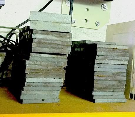

As I said, there are two different kinds that Bob has (that I know about from just poking around his back-room area), and when he saw me playing with a stack of the flat ones, he made me put them back EXACTLY like he had them so that it wouldn't mess up the strength or some such thing of the magnets.
The segmented ones had a different color than the flat ones, and a different shape, of course. Bob would probably know what the things are made of. The segmented ones were packed in some kind of corrugated kraft paper in batches of 100.
The color may have been from some kind of preservative for all I know. They had a dusty silvery color, to my eye, whereas the flat ones were dark gray.

Found the iPhone pics. Here are the segmented magnets:
Here are the flat ones, which Bob said were used in later Mosrite pickups:

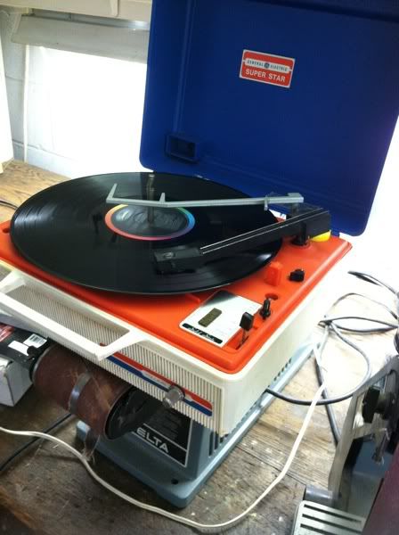

And here is Bob's vintage record player, which runs at about 37rpm. Can any of you old-timers guess what we were listening to that day?!??! One of two bands, and both started with a "B."

The segmented magnets look more like the ones I pulled out of the 70's humbuckers. The ridges in the ones I've seen in pickups from the 60's look a little narrower. After seeing the photo, I'd have to agree Eugen that they were probably intended to be broken off at the desired length. As for color...its really hard to judge the material based on the color. The magnets we use primarily have a dusty silvery color. But to my knowledge, the only real difference is whether or not they're left in the rough or polished (like those pretty ones that Stew Mac sells for an arm and a leg.)
As for magnet strength, yes playing with them could possibly change the strength since rubbing them against each other and other ferrous materials cause those little electrons to jump around from one object to another. You could also screw up it's orientation. But, thats why I like to purchase non-charged magnets. We just charge them before installing them usually.

Does he always put his record player on the belt sander?
- JimPage
- Posts: 984
Re: Sarah's pickups restauration.
Hey!
If that's what that thing is, yep! I suspect Bob has more than one belt sander, though. He has a lot of hardware.

Oh, and yes Sarah, the belt sander is now my record player holder. You are very observant!
- panther
- Posts: 817
- Location: Anza, California
The label is Beatles. Capitol Records. My guess, Beatles and the Byrds.

Could you give us an example? I can't hear the difference. What material are the break-away magnets made of? Alnico? From what I have studied about magnetism and electricity in college, I can't see a direct correlation in the break-away design and tone. The only thing that would have any bearing is the magnetic field and the gauss (as you mentioned.) Thats why I make sure my magnets are charged at the same strength before installing them in a pickup. But could you give me a rundown of exactly how the the little ridges in the back of the magnet affect the tone?
I have a source here in California who can cast the magnets for me that way if we really want them.
