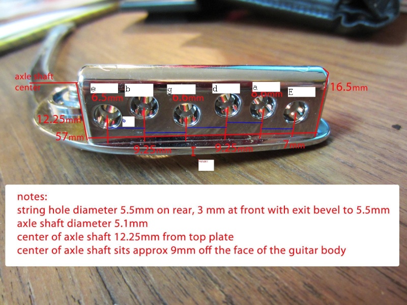

A=5mm
B=9mm

Also, I'm not reading the same measurements for the string hole locations as you have drawn in red. If you will assign the a letter I will give you those individual measurements.

thanks a lot Dubtrub
the strings holes name by their string go in
thanks you for the all mesurements
for the string hole i read here they are hand made then it must be some difference
during this time i have continue to draw with inkscape and i have a good template i think
more or less at scale with the position of the axis and the spring
i have to compare with the new mesurement
best
ludo

Re: style" mosrite of burgundya"
e=5mm
a=7mm
d=6mm
g=4mm
b=7mm
e=4mm
Your other measurements on the string stop bar look correct.
a=7mm
d=6mm
g=4mm
b=7mm
e=4mm
thanks so much
now i will made a hand drawing to see if all feet and i can beguin next week i hope
i have recept the tracing of the bridge for the shape by a nice member
then i hope beguin really soon cause this beguin of week the milling machine is busy
maybe tomorow maybe next week
recept my springs
again some things to think about (some mesurements miss or be contrary
i try to finish my plan this week
