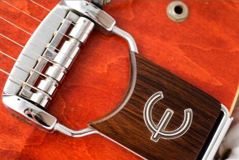

As an aside, the Vibramute wasn't the only attempt at a solution to this problem. Another was the Epiphone Tremotone, which functions much like a Bigsby, except each string goes around a cylinder of a different radius. Here's one pictured on a mid 60s Casino. I've never tried one myself to see how well it works. Looks cool and a bit easier to string than a Bigsby!
