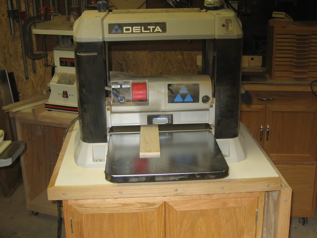

Thickness plaining finger board

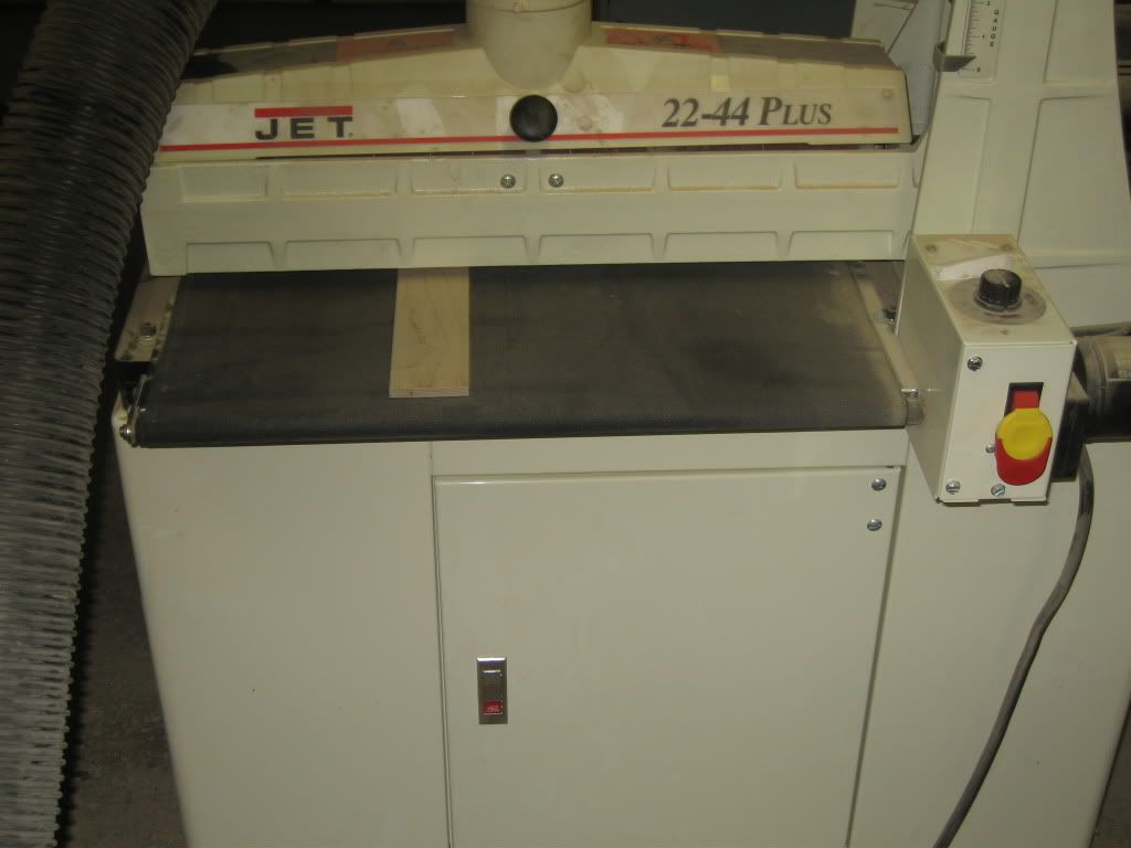

Danding finger board to .250.

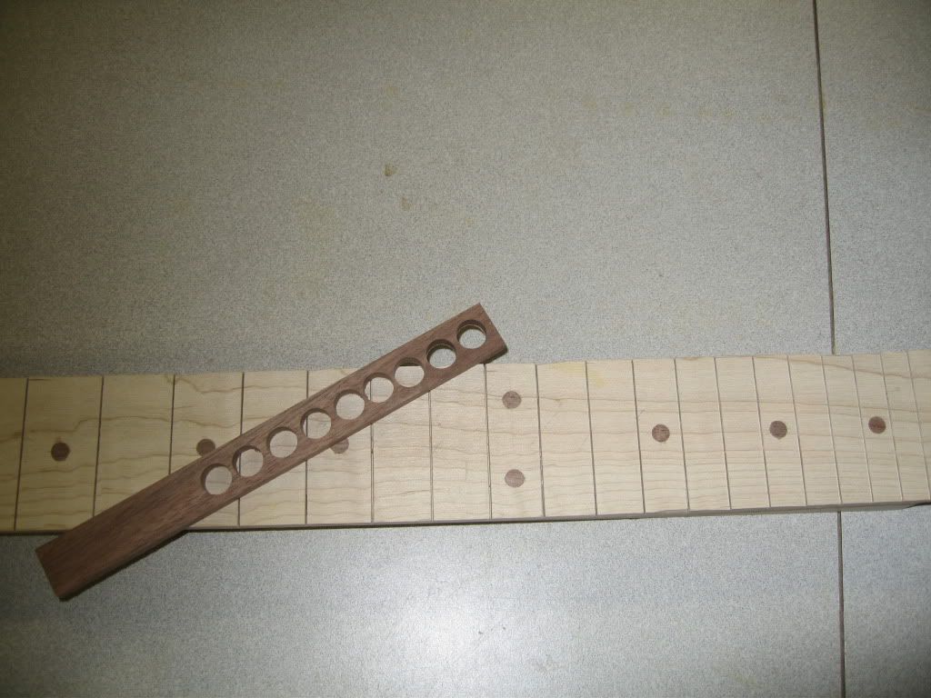

Installed wallnut markers on finger board

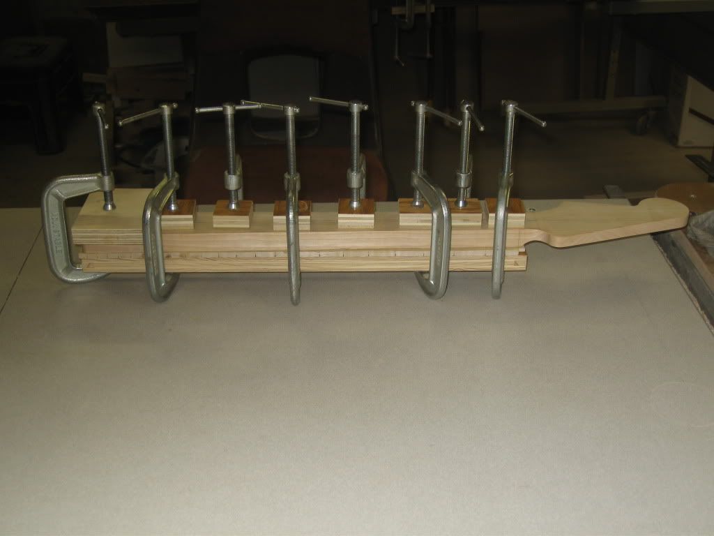

Glueing finger board to neck

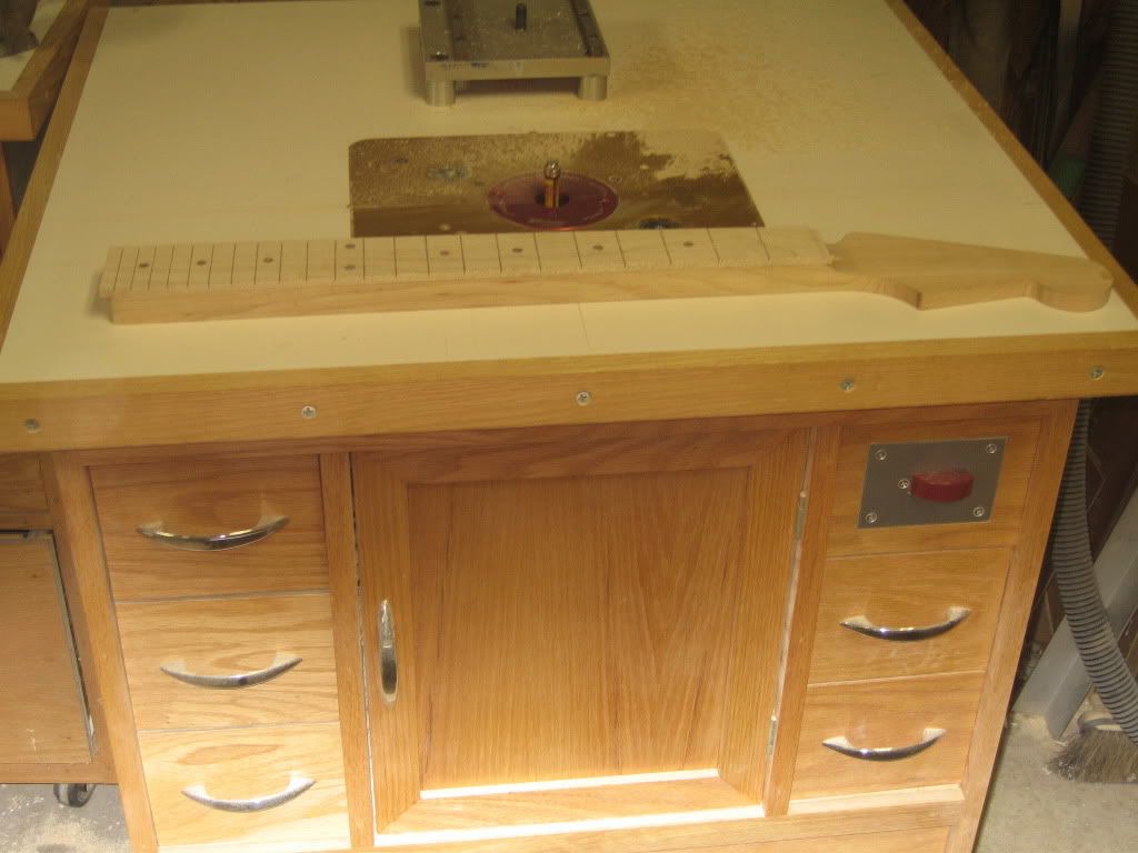

Routering finger board to fit neck

Hey woodchuck30, I hate to be the bringer of bad tidings but check your dot marker on the 18th fret; all my guitars 'say' it should be on the 17th. ;)
I trust you're still in time to remedy that. I admire everyone who has ever made an attemt at making his/her own guitar!
[edit]while you're at it, don't forget to place one on the 19th fret also :geek:

Veenture wrote:Hey woodchuch, I hate to be the bringer of bad tidings but check your dot marker on the 18th fret
Woops! Isn't the learning process grand. Certainly looking grand otherwise.Take out that one marker and replace it with an oblong diamond shape piece of Maple and reinsert the wooden makers on each side of it. Everyone will think it is nothing more than a cool looking inlay. Make it look like it was intentional. That's what Semie would have done.

O S.... I always screw up someplacealongtheway. See what I mean :lol: No problem, I can cut a plog out of maple and match it in, you won't even know I made the mistake, If you don,t tell :lol:

woodchuck30 wrote:O S.... I always screw up someplacealongtheway. See what I mean :lol: No problem, I can cut a plog out of maple and match it in, you won't even know I made the mistake, If you don,t tell :lol:
...we haven't seen it...we know nutin'... :twisted: (don't forget to put a marker on the 19th fret too...)
And don't you worry...the best guitar makers are the ones who never have (made one)...like me :oops: ... :D

Hay dubtrub, you say it's in the learning process right? Well I better learn to count. :lol: :oops:
