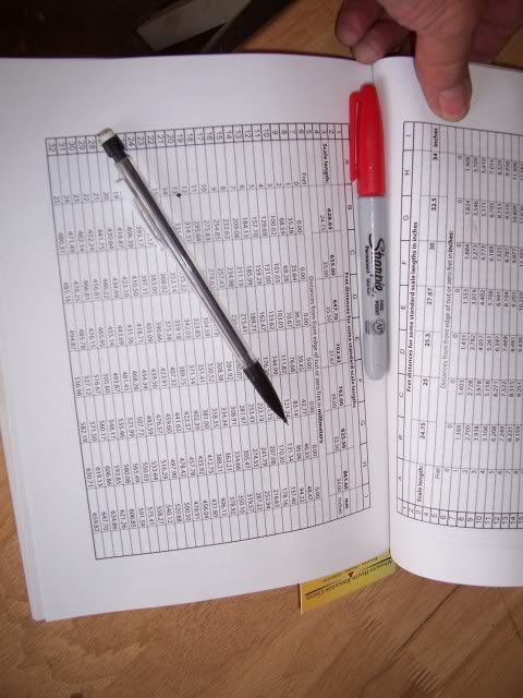

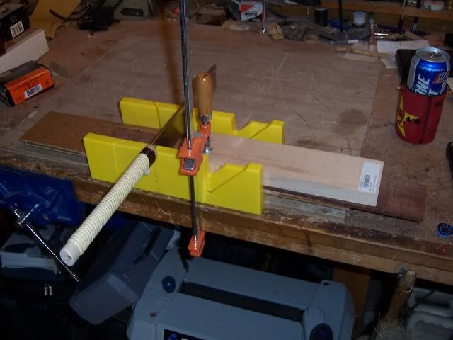

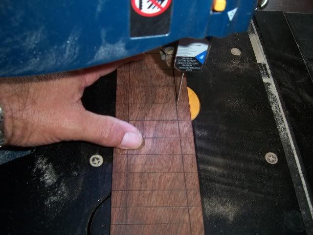

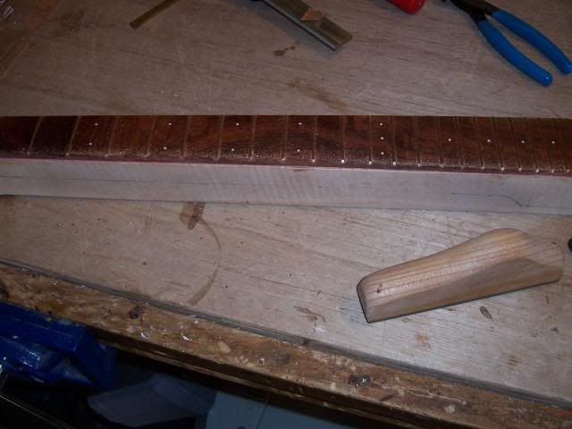

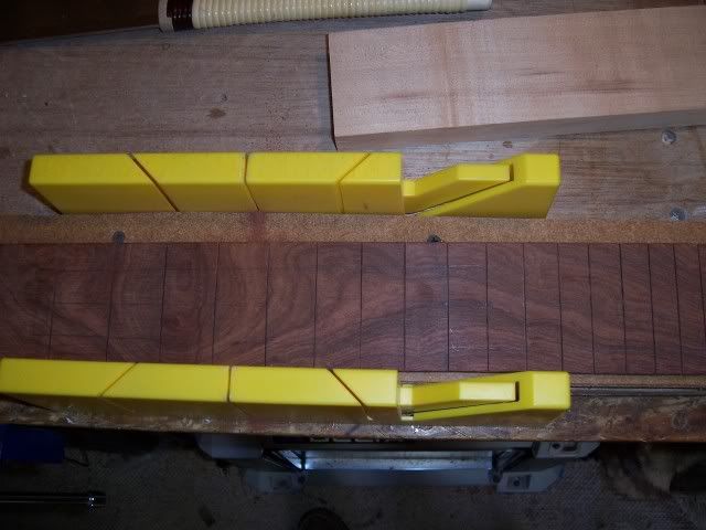

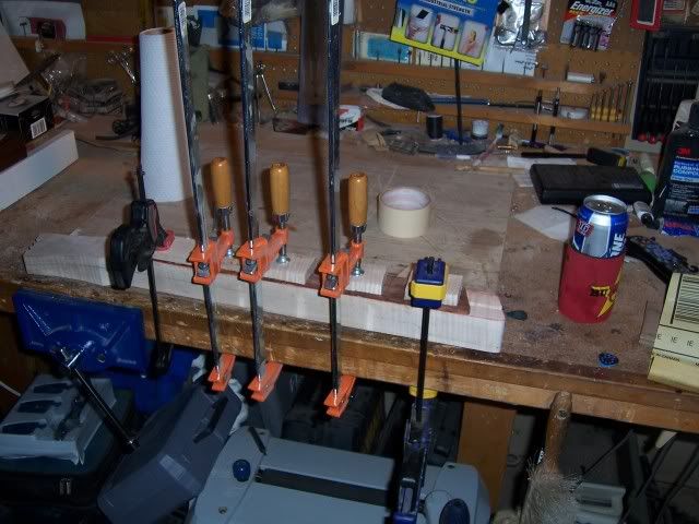

Finally got around to making the fret board and neck
Good book!!!

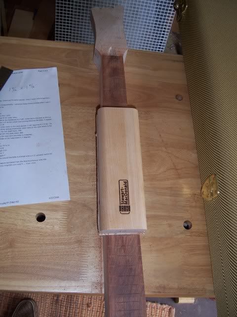

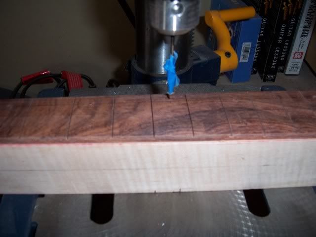

slotting jig
BTW that was not an ADULT beverage in the pic!!! just a prop
Time to PLAY
Good book!!!
slotting jig

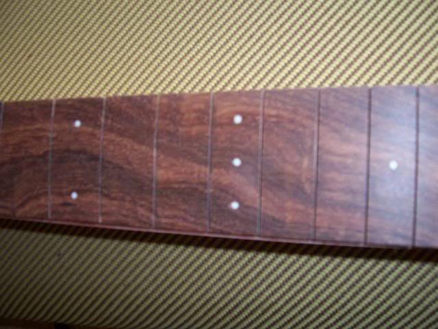

Re: My first attemt at making a Mosrite clone.

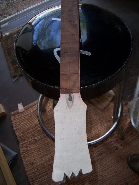

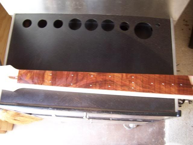

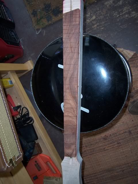

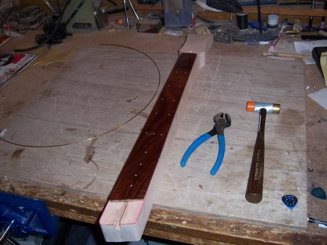

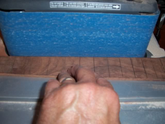

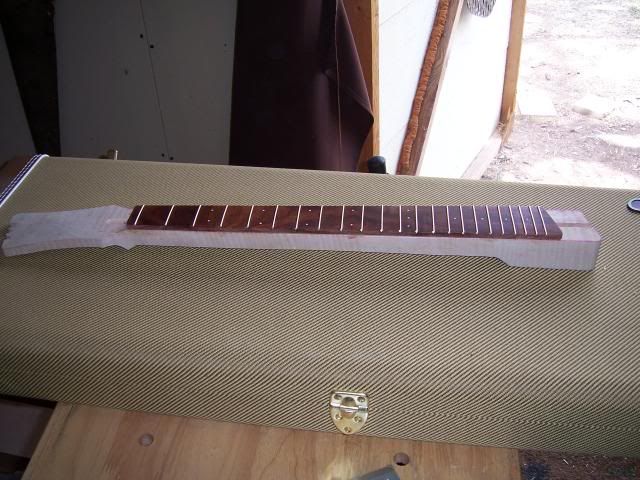

A few more pics of the neck build.
Wow! Great work and that's one gorgeous piece of rosewood!
- bluther
- Posts: 42
- Joined: Tue Jun 30, 2009 5:56 am
- Location: San Angelo, Texas
Thanks .A fellow wood worker gave me enough of that rosewood to build ,probably, 10 boards easy. It is real old stock and hard as a rock.
