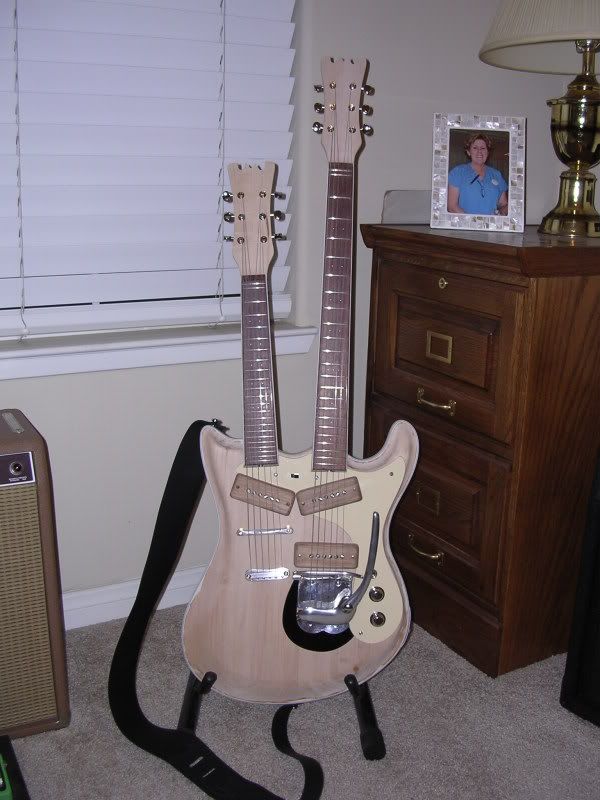

Postby dubtrub » Mon Oct 19, 2009 9:36 am
Here's the latest photo taken last Thursday. I have been away on a camping trip over the weekend and haven't had a chance to wire and string it but hopefully tomorrow if I get all my 'chores' done. ;)

Re: Mosrite 'Knock Off' Project #6 double neck
Postby Veenture » Mon Oct 19, 2009 10:44 am
Coming on nicely dubtrub.
Just looking at the headstocks again, they don't appear to be as "off-set" as the Mosrite headstocks we're used to seeing and the same goes for the tuning pegholes -they seem to face each other at right angles if you follow what I'm trying to say. Not that it is important...just an observation. Perhaps it's an optical illusion?

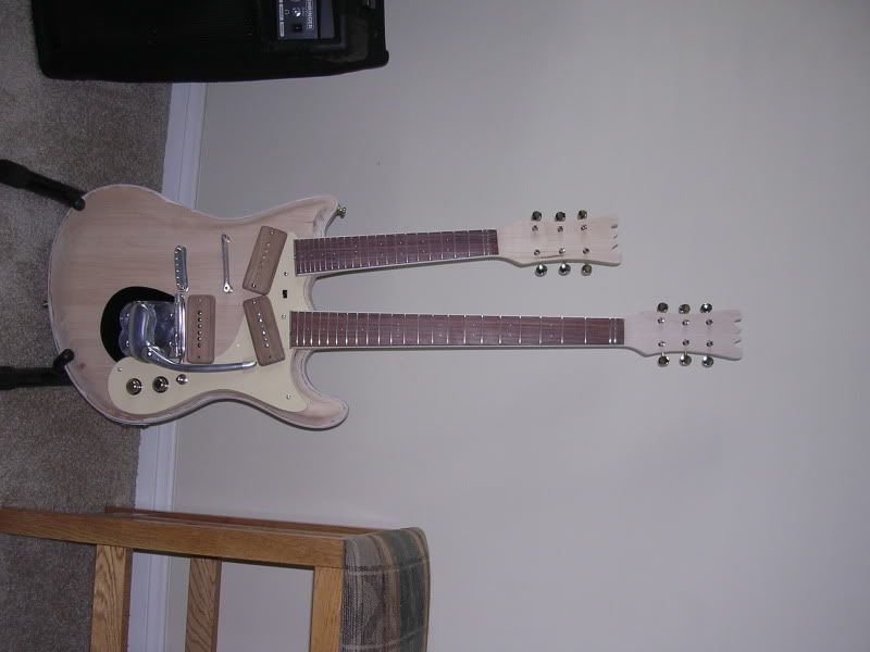

Postby dubtrub » Mon Oct 19, 2009 11:06 am
Paul,
The early double necks and Mosrites in general did not have the off set M shaped headstock. That was a design Semie implemented when he started the with the Ventures contract.
This one belongs to collector Michael Marks and is dated as a '59.

Postby dubtrub » Thu Oct 22, 2009 12:26 am
Well it still looks the same but it is now a playable guitar. It sounds fantastic with the modified Hallmark p'ups with the pole pieces changed to slightly larger 6X32 American machine Fillister head screws as was on the original Mosrite. Apparently the larger screws gives it more magnetic pull as it sounds virtually the same as my '64 and '66 Mosites. Also going with a longer 15 inch octave scale made it much easier to play compared to the shorter scale on Doug Brewers double neck. The next photo's will be the sun burst finished product.
