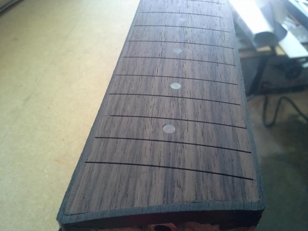

I have been rethinking the shape and position of my Volute and looking a reference pictures and my own Strat, I have come to a conclusion. The Apex of the Volute needs to be closer to the Nut. Or between the zero fret and string guide in this case. Makes sense to me. You can want your hand to butt up against it when you slide to the top of the neck.
(at least on original Mosrites. Hallmark seems ti make their Volutes Farther back)
Mosrite examples:
Hallmark example: apex farther up the neck
My line was back too far. So I'm redrawing mine a few centimeter closer to the nut.
here is the old line:
My new line: Starts at string guide

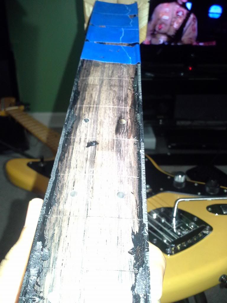

Postby cmiller0034 » Mon Feb 03, 2014 4:15 pm

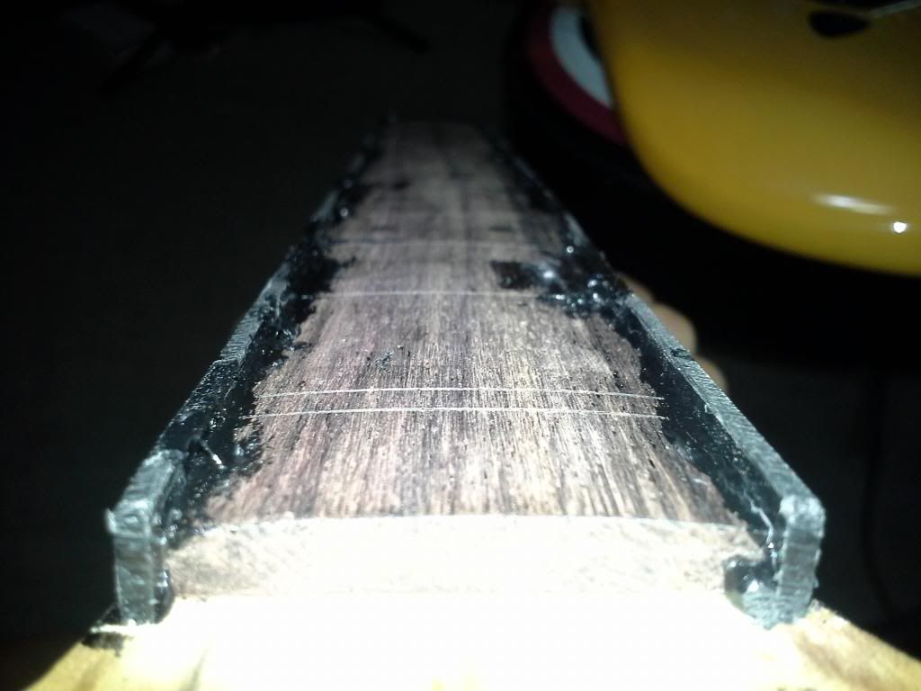

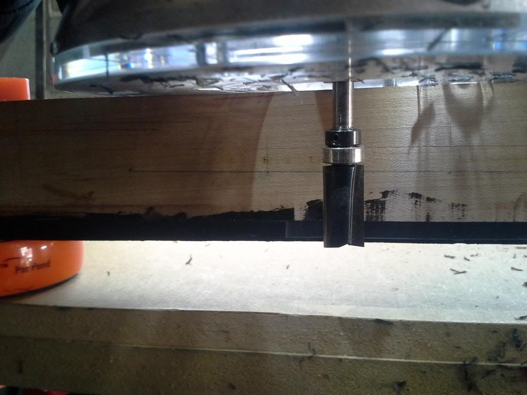

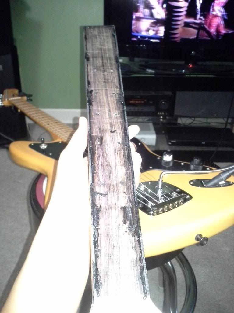

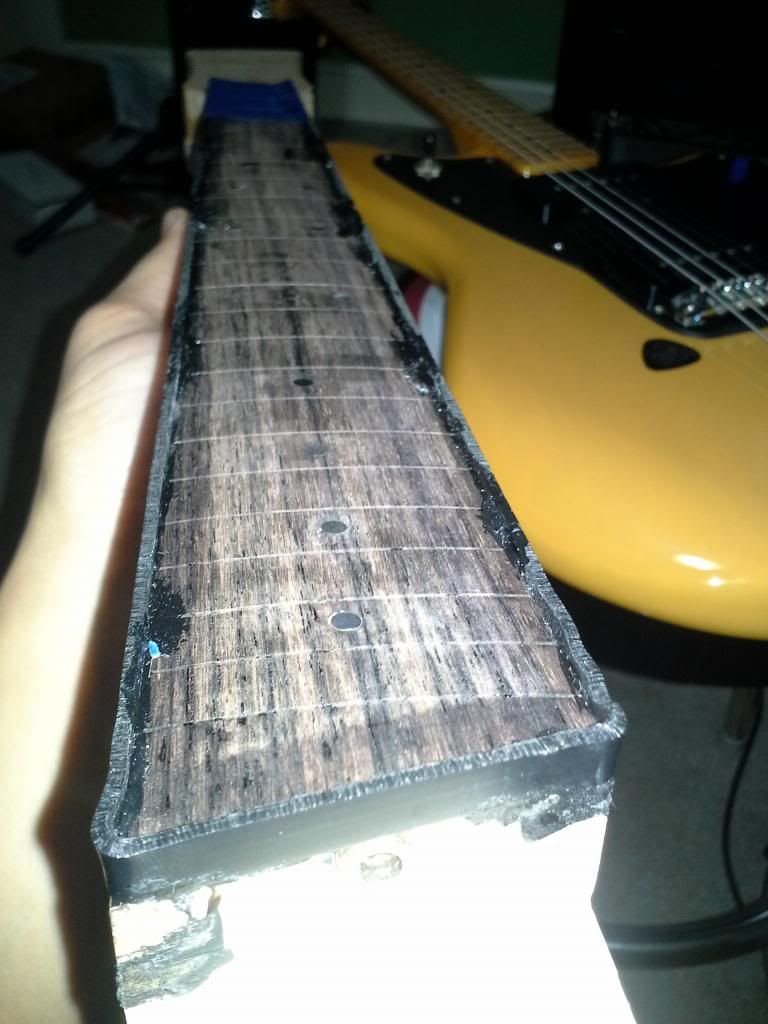

These Bindings are STRONG like BULL!
I thought cleanup would be a nightmare but not so far.

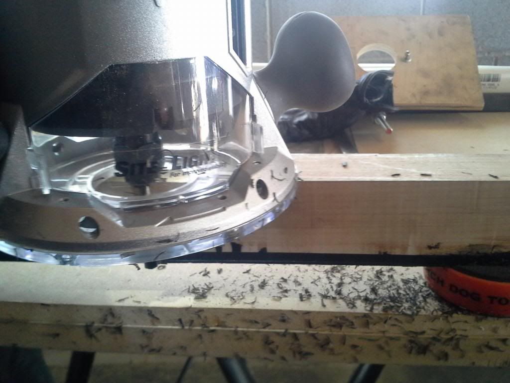

used a flush trim bit to cleanup because Im too lazy to do it all with scrapers ;)

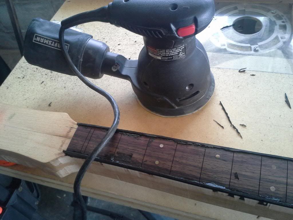

Took high ridge of binding down close to board with orbital sander. Again because I'm lazy.
couple of passes with sanding block and 80 grit
few more with 150 grit
few with 180

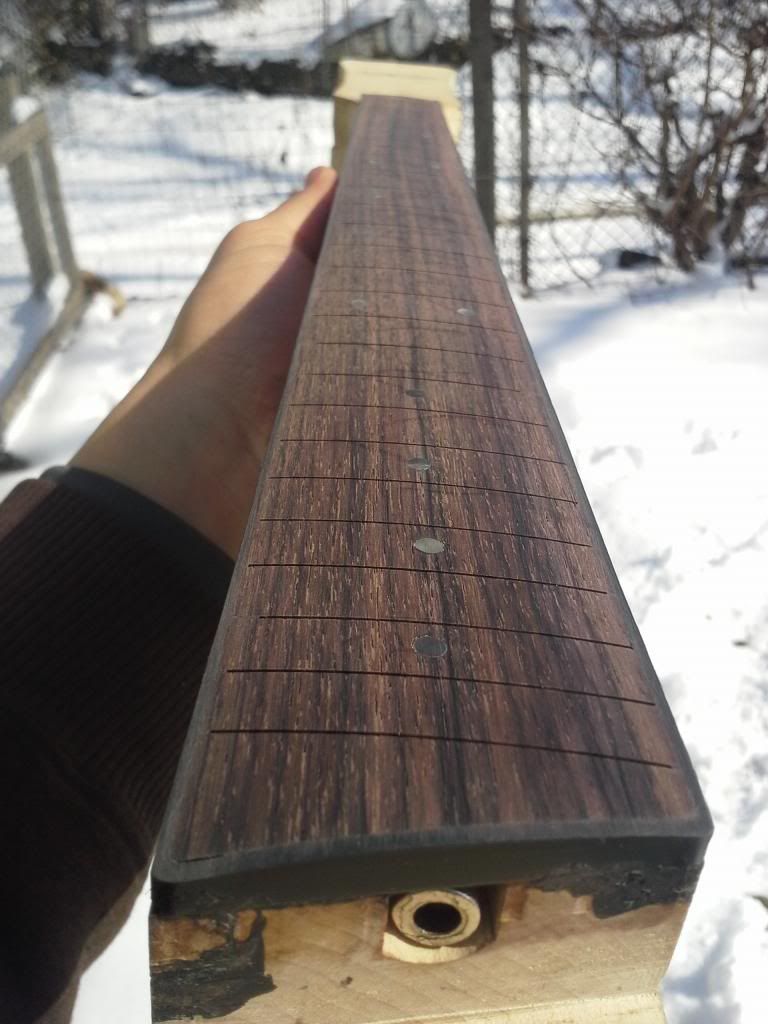

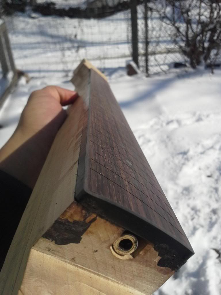

Sides still need to be scraped and the slots need to be cleaned out. But looks ok. Im happy with the way it turned out feels like part of the wood.
Cheers!
