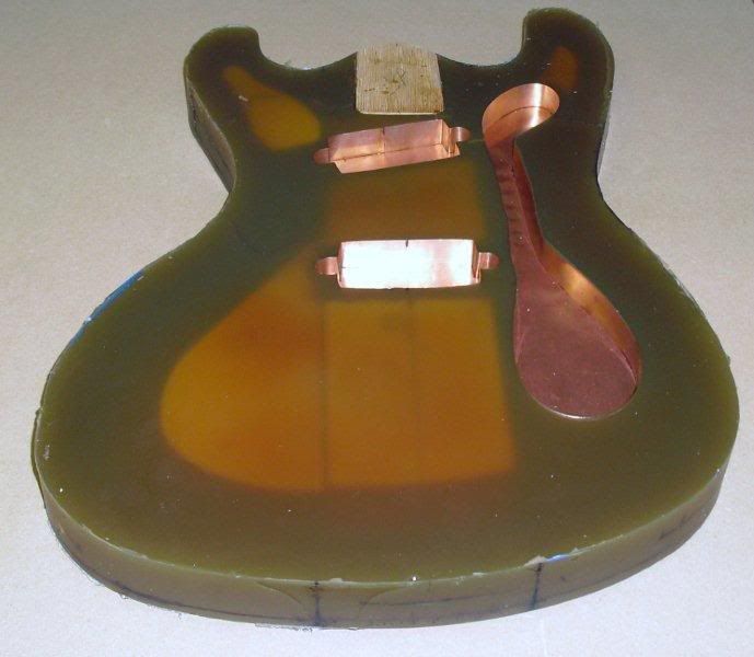

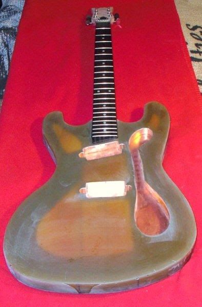

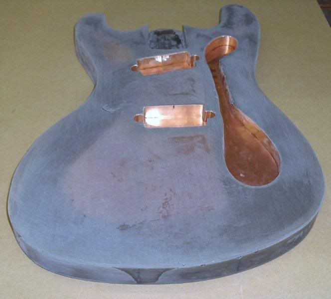

Well, I made it at under a gallon of resin, In fact with a little more planning I can probably get it down to 3/4 gallon.
Here are 3 photos, One right out of the mold, Second partially cleaned up, Third with the neck I made in place.
As seen in the 3rd photo the guitar weighs in at 8 lbs, but I have a lot of material to remove yet so I'm guessing about 7 to 8 lbs when finished.
Re: Venture a Guess ?
Postby Sarah93003 » Sun Jun 05, 2011 9:55 pm
Cool! How does it feel? Is it just the photo, or are the pickups a little too far to the left? I'm anxious to see where this goes!
panther
Posts: 817
Location: Anza, California
Postby panther » Sun Jun 05, 2011 9:59 pm
The neck pick up was off by 1 string. I had it figured correctly at first, and moved it, but the move was wrong. No big deal just cut out the right side, and fill in the lefty. Not like wood, I'd be screwed. I still have alot of carving to do before I mount the hardware for final fitting.
If you notice the PU and control cavity are both shielded, and it's molding right into the body.
