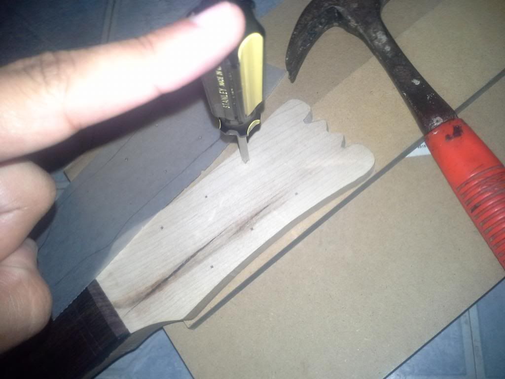

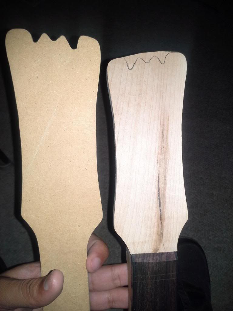

I trimmed the bottom of the headstock and fortunately the rot does not come all the way through. I will use bob shade's method of repair and post pics later. Im tired now. Maybe time to call it a night.

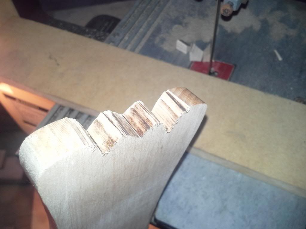

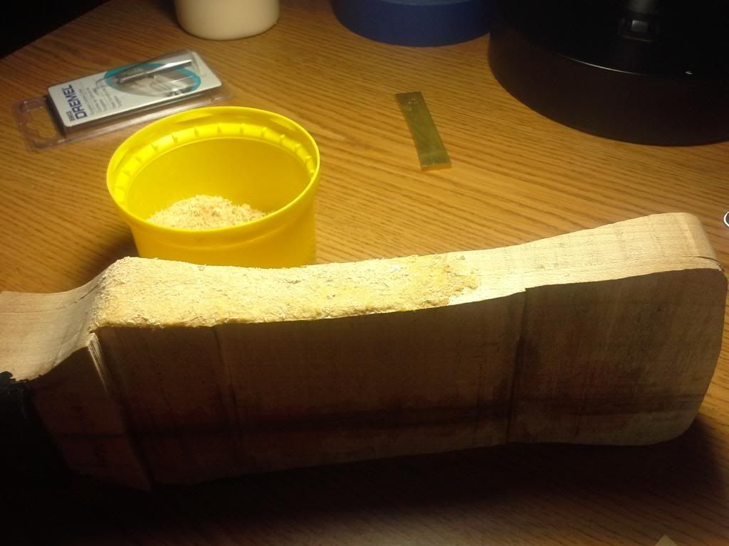

The other side of the headstock has no visible rot.
another ice storm
clamps
Thin super glue 3 layers applied into the cavernous crack
After about 3 hours and several layers had cured, I used the cheaper thicker stuff to fill up the gap
I thought superglue was supposed to harden quickly...
and 12 layers thick
Still not filled all the way. But I'm confident most of the pores and crannies have been filled underneath.
Thanks Bob Shade thanks Black for the suggestions. I can move on to sanding down the headstock.

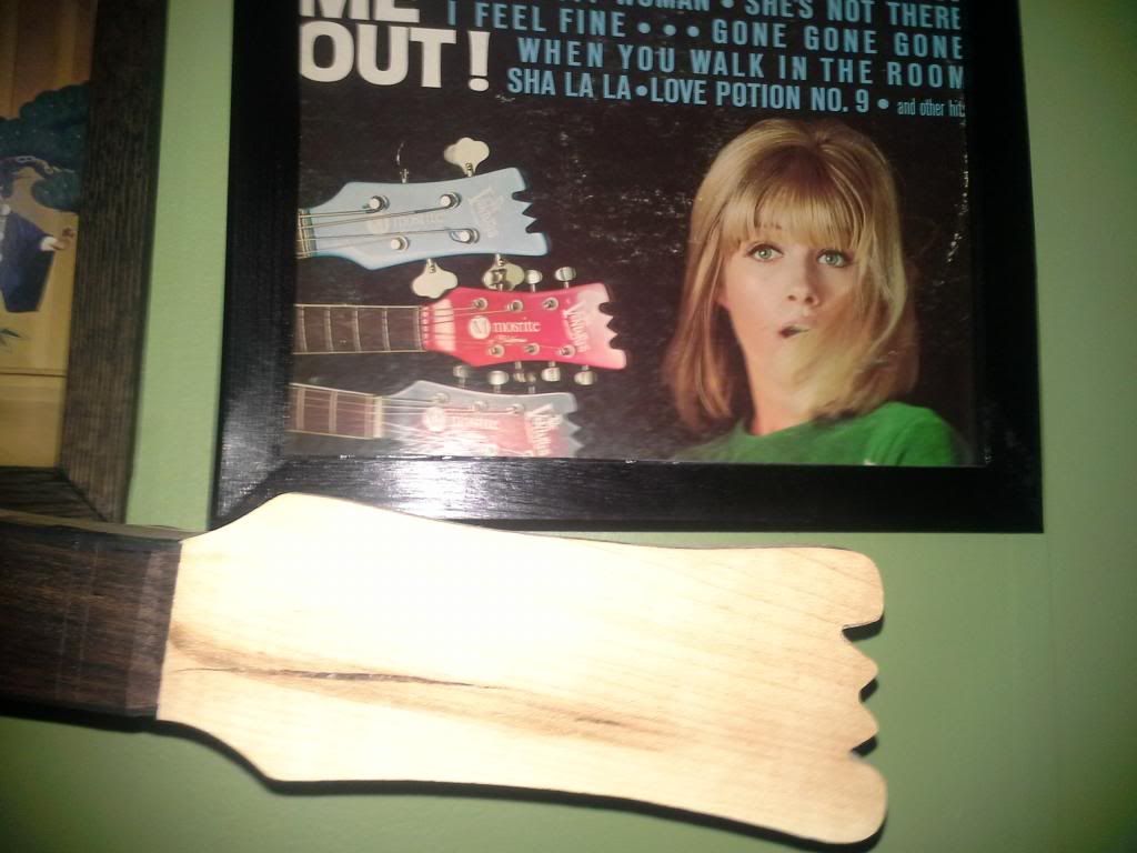

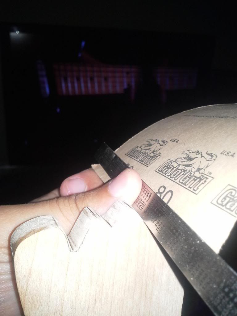

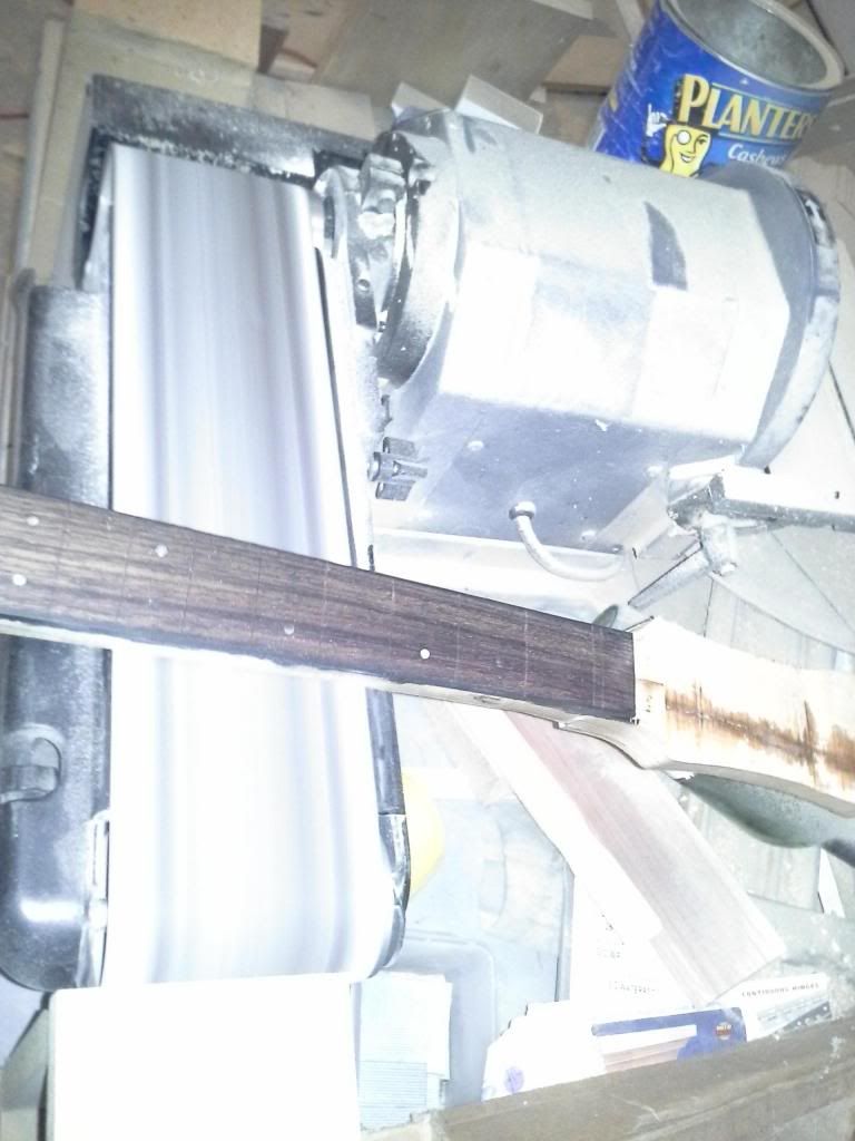

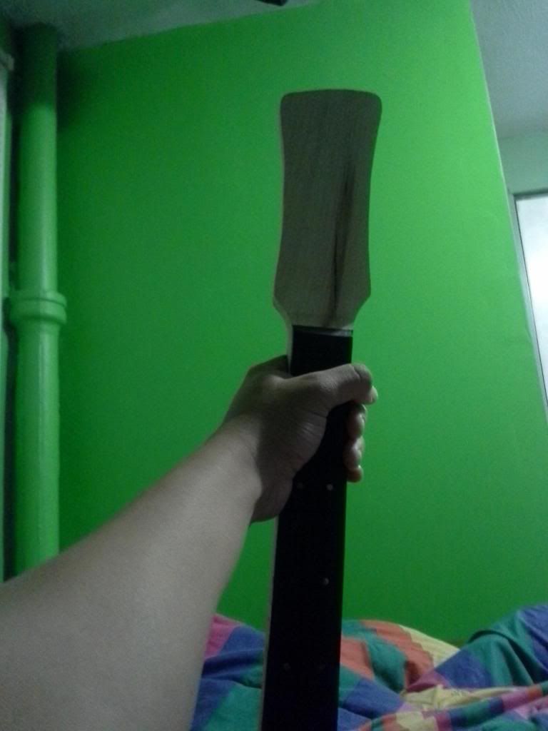

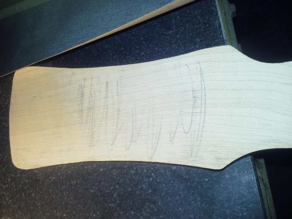

Alright been doin' stuff. Sanding mostly. Some parts came out ok. Pics mostly self explanatory. GOOO!!
filling mistakes

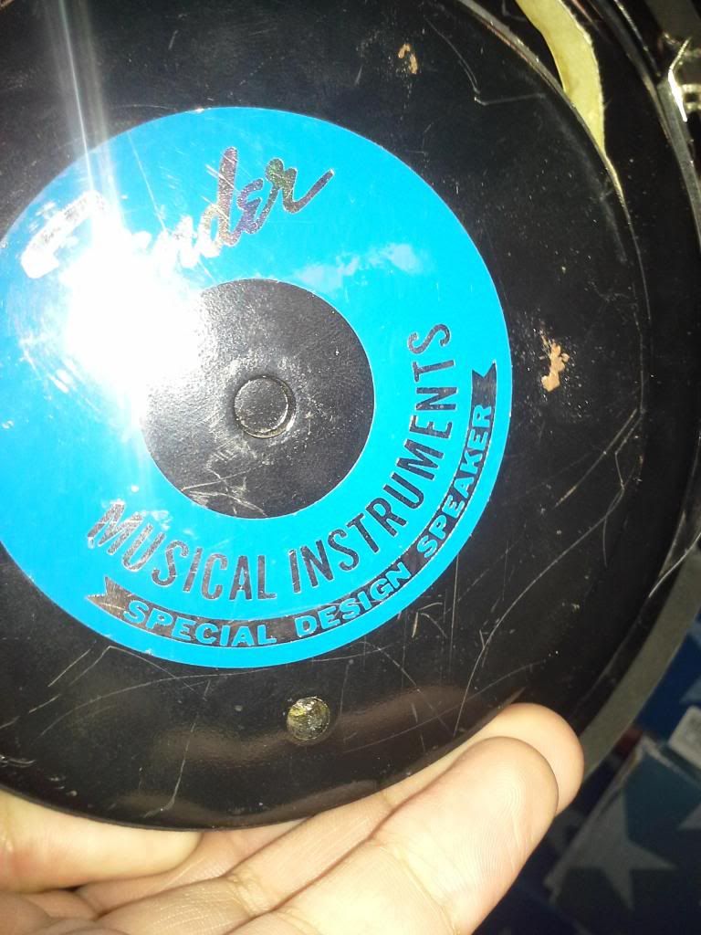

later that day found a 12" Eminence at Music Go round. (LOVE THAT PLACE)

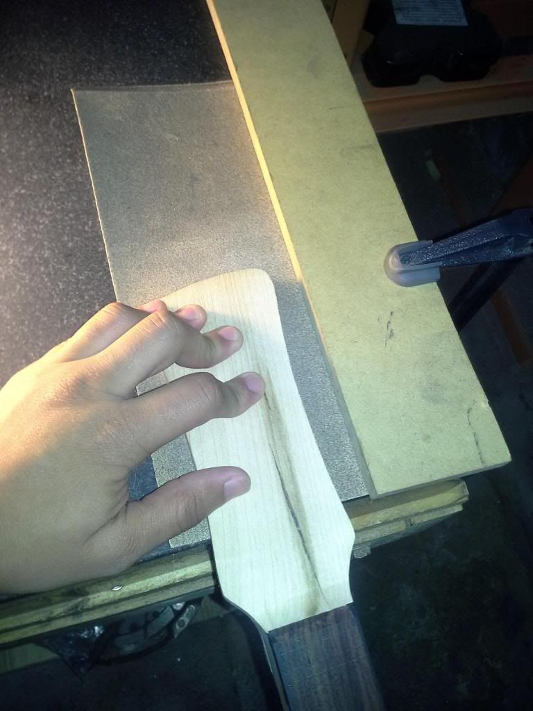

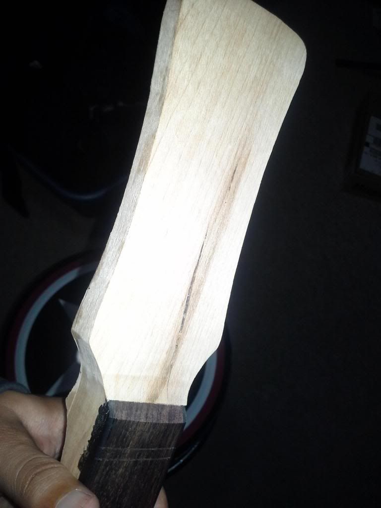

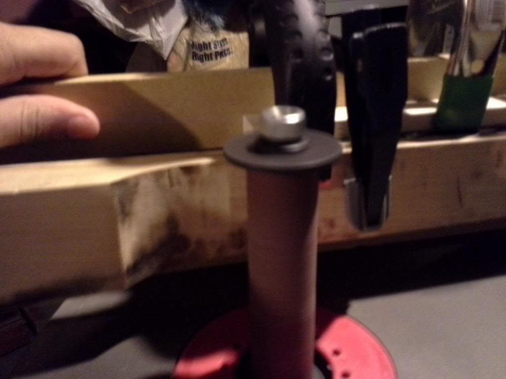

Went over to my buddy cliff's to use his belt sander that weekend. Home Depot Sanding belts are expensive! Headstock came out a little crooked and neck thinner than I wanted. It was around 7 degrees in his Warehouse and I wanted to get out of there ASAP! should have taken my time.

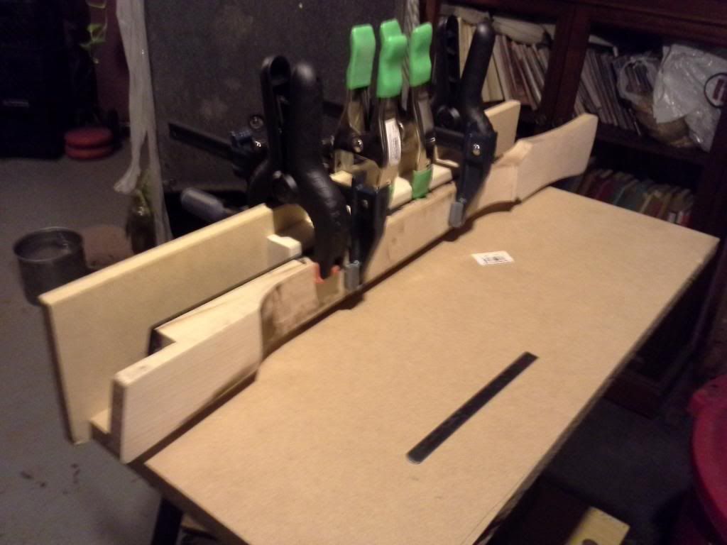

Later at home tried to make a jig to help with sanding straight.
neck slants toward the Bass side a bit. hope it does not keep the Guitar from staying in tune.

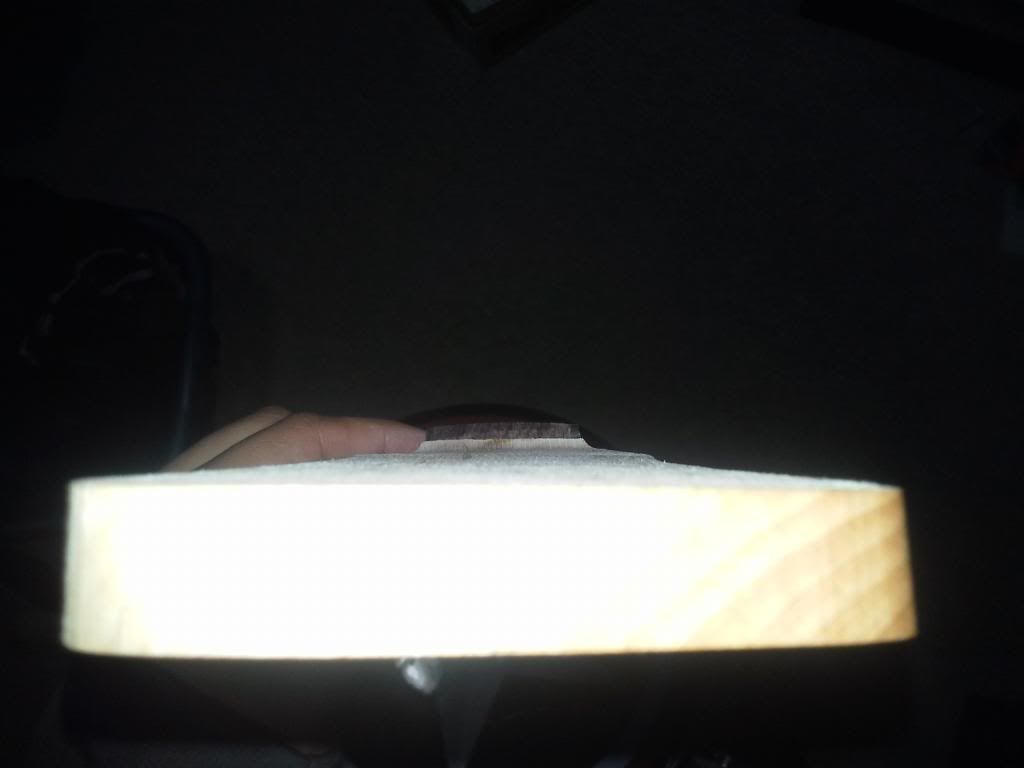

sanding the head flat on my Granite block. I want the tuning pegs even as possible.
low spots
ready
sand sand sand
While I sanded this Video was playing constantly. Cant stop listening to the Shivas! (also cant remember how to get this to show up in a window)
enjoy the manic energy.
https://youtu.be/eHTaC6-xZ_0

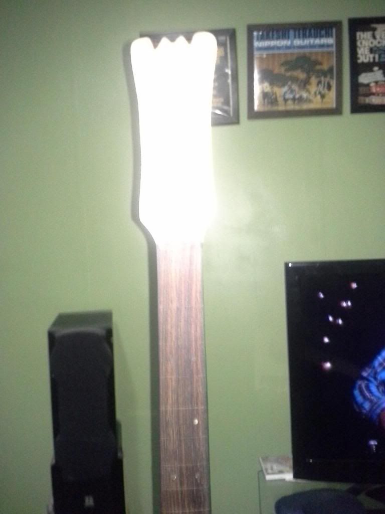

Starting to look acceptable
https://www.youtube.com/watch?v=JCFaCjj7q9Y#t=4
Acceptable
to do: peg holes. neck shape (deep dread fills me). frets. string guide
that is all.

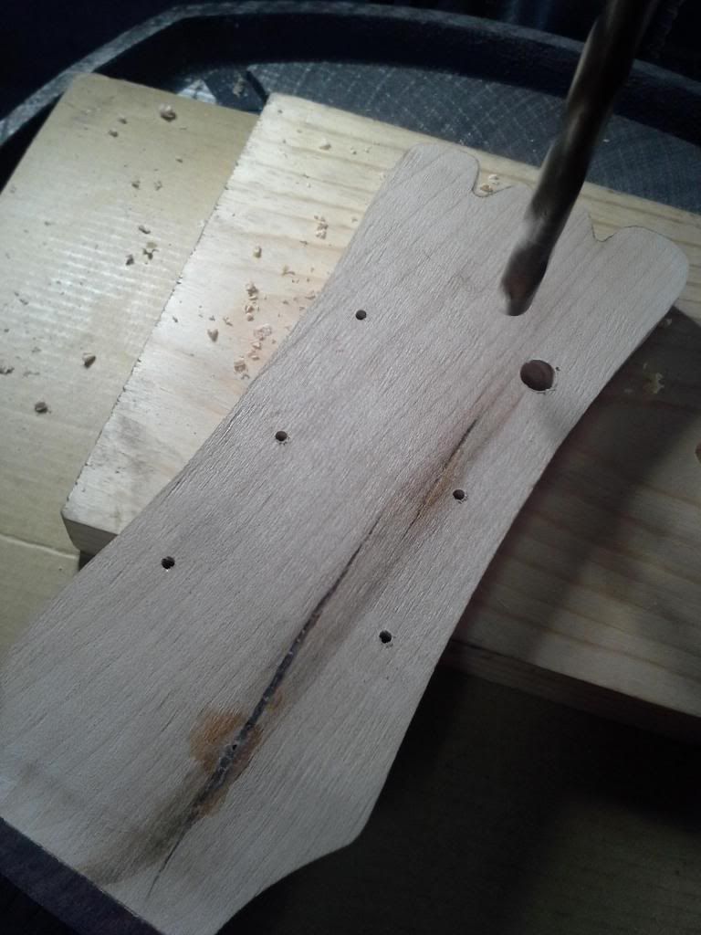

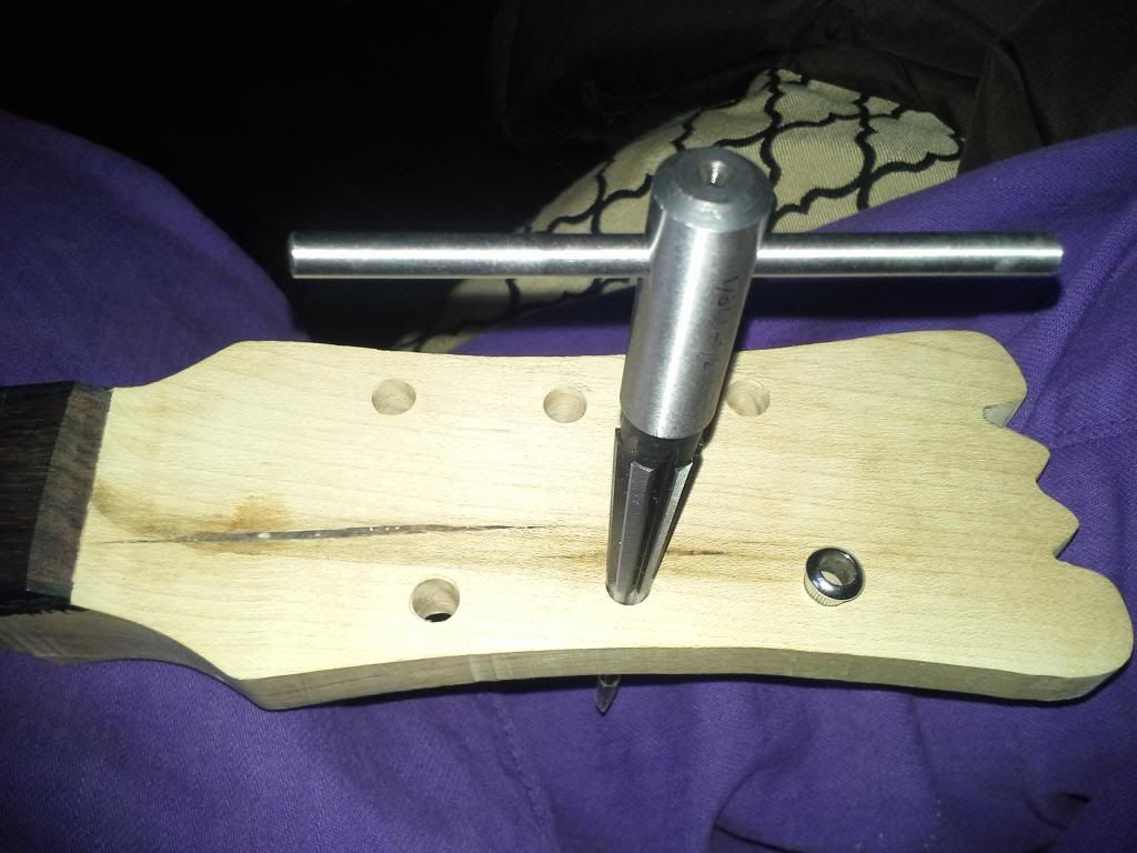

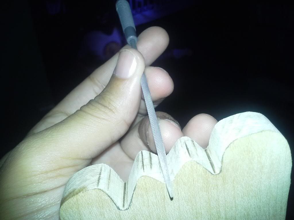

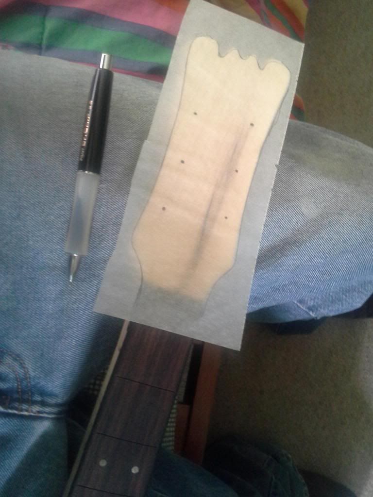

Things were coming along relatively smoothly. Peg holes were drilled.

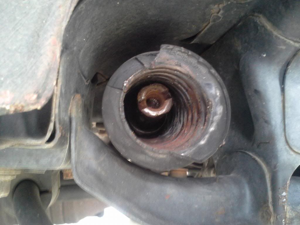

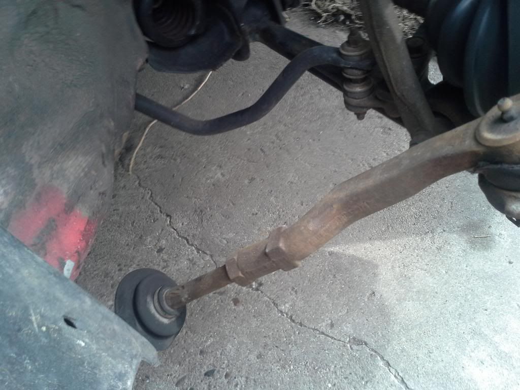

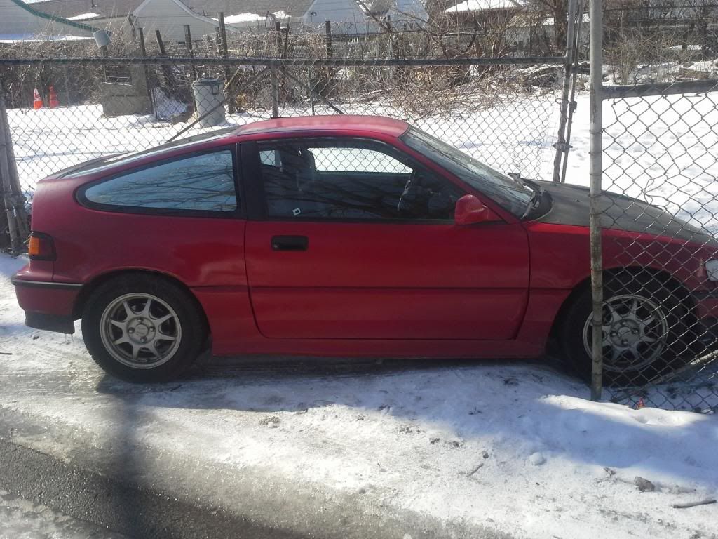

Stripped out Rack & Pinion assembly on an already railing +20 year old civic.
Forcing me to use this as transportation in the middle of winter
Resulting in an accident due to BLACK ICE a railroad crossing last week. Trashing both my bike and my left wrist.
