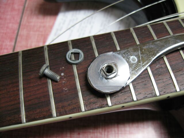

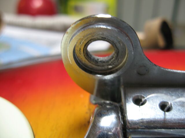

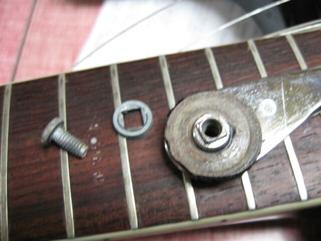

OK, I bought myself some diet cokes and performed the surgery. My Mosrite had both a leather gasket and a cardboard gasket underneath that. First I tried adding the plastic under the cardboard, but it still kept loosening. Then I removed the cardboard and got much better results, though it still loosened a bit, so today I disassembled it and added a touch of lockwasher which seems to hold it well. Below are some pictures from the process. I'll have a better idea of durability after my 3-set gig tomorrow night.
First, the underside of the tremolo mount. Nothing particular to see here, just included because, hey, I haven't seen any pictures of this on the internet before:
next the original leather and cardboard washers
and finally the leather with the plastic.
