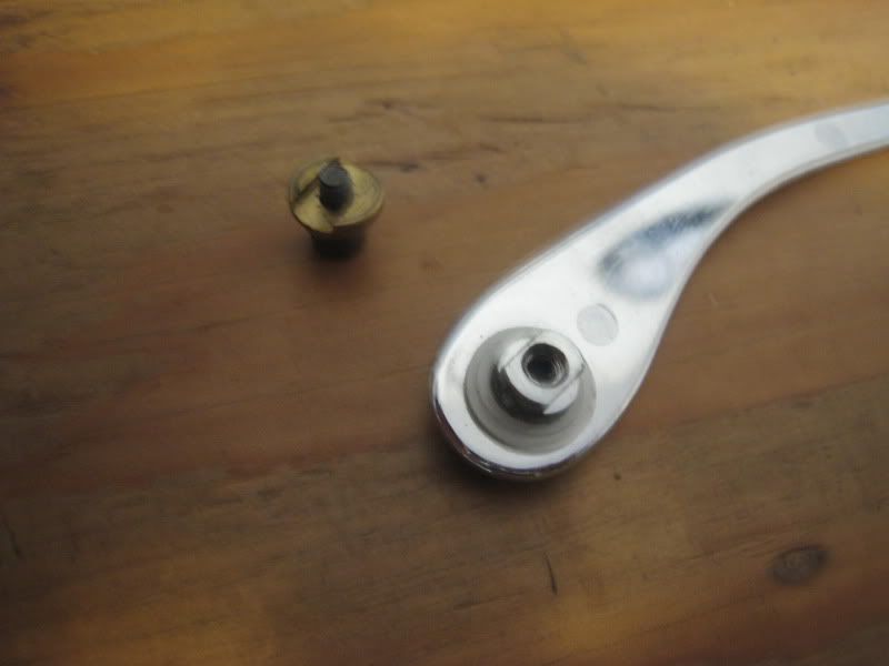

Also, I was about to try the loose arm->leather washer->plastic washer->bridge thing, and discovered a curious difference between Mel's and my MIJ Mosrite:
Nope, the part that the hex screw goes into does not seem to come off! I just tightened it, and seems to be holding steady, but I may get some loctite today anyway. One for the archives I guess.

Postby rog43win » Fri Feb 12, 2010 5:34 pm
Hmmm.....I never saw that arrangement....screwed to the arm like that......when I had my Mosrite, the arm was looser than I like, but it's because there was a gasket-like, cork material washer just under the arm...and after some use, it compressed enough to make the arm loose.....drove me crazy, .....I thought there must be a better way to make the arm tighter besides a cork washer.....

FritzCat
Posts: 269
Joined: Sun May 04, 2008 5:52 pm
Location: Sonoma, CA
Re: Excellent 65 Optimizations
Postby FritzCat » Sat Feb 13, 2010 12:25 pm
This isn't a great pic, but here's what it looks like disassembled

Postby morphball » Mon Feb 15, 2010 11:33 am
FritzCat wrote:This isn't a great pic, but here's what it looks like disassembled
Dag... so I just had to keep unscrewing it. :roll: It seems to be staying put anyway, maybe the hex-type of setup doesn't need the washer trick as much.
