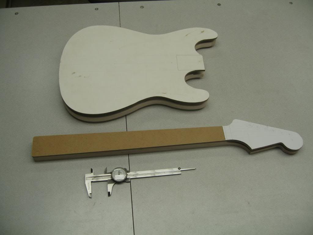

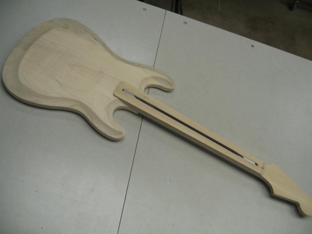

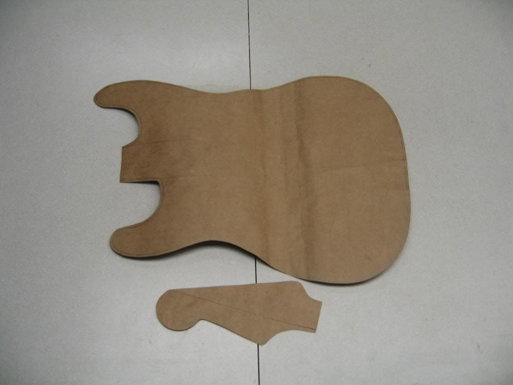

Paper traceings of a strat
Used maple for the body and quarter sawn maple for the neck

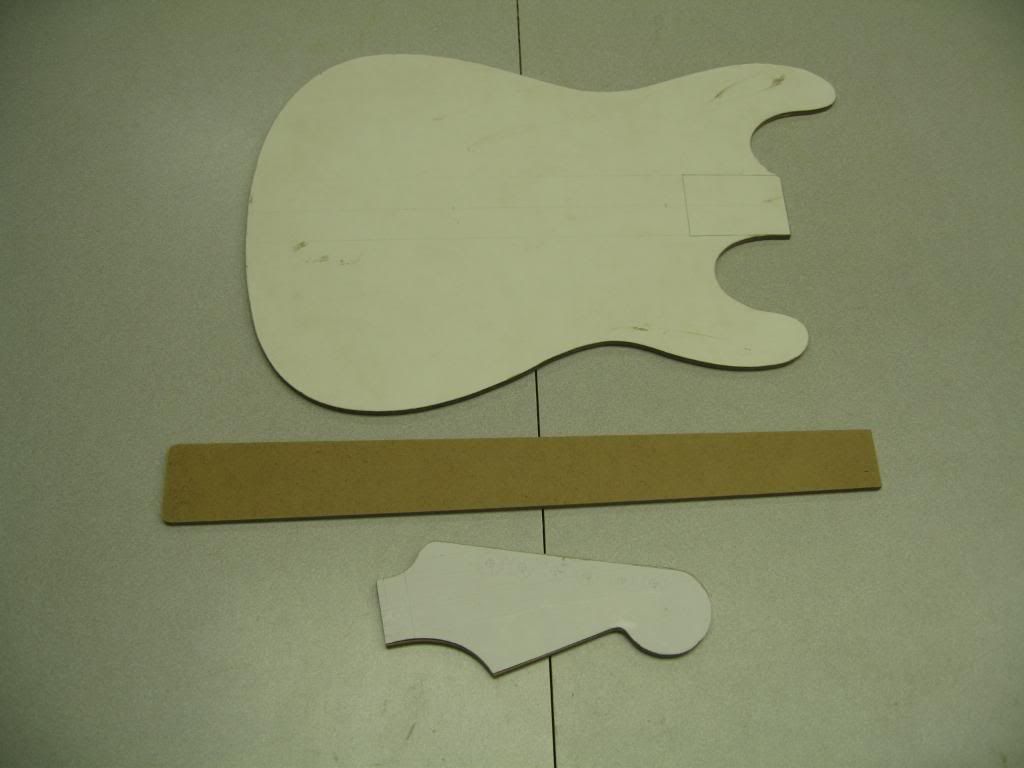

Templts

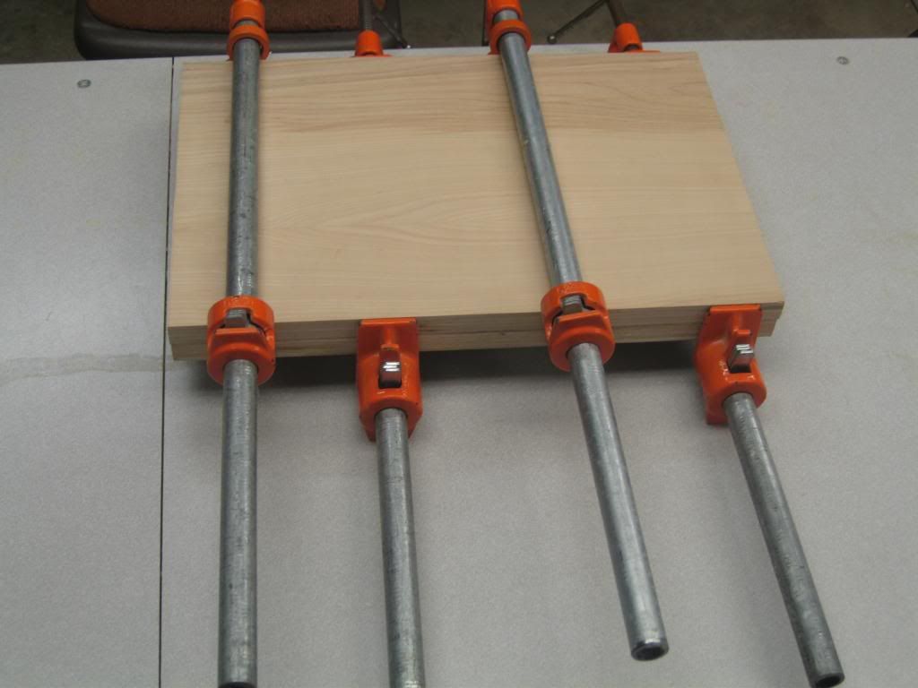

Glueing blanks for the body

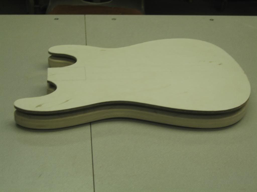

Blank after cutting on the band saw
Body and neck after final cutting on router table.

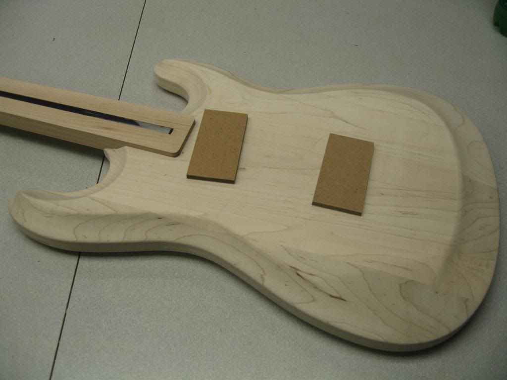

First attempt at german carve,and routered neck pocket
woodchuck30
Posts: 434
Location: Ortonville Mi
Re: new project half bread guitar ..cont...
Postby woodchuck30 » Sat Feb 13, 2010 5:15 pm

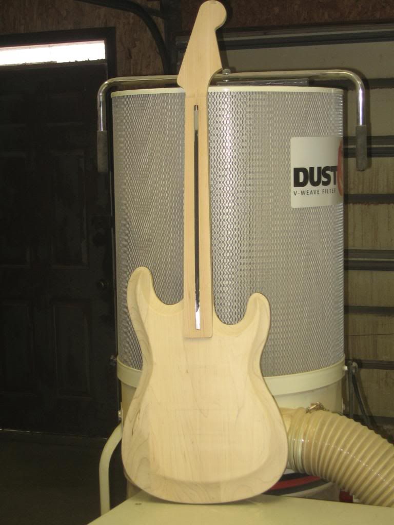

Dry Assembley
Layout for pickups
final fit + or - .003 neck taper 0.8 degrees in neck pocket..press fit
front
back
no screws.

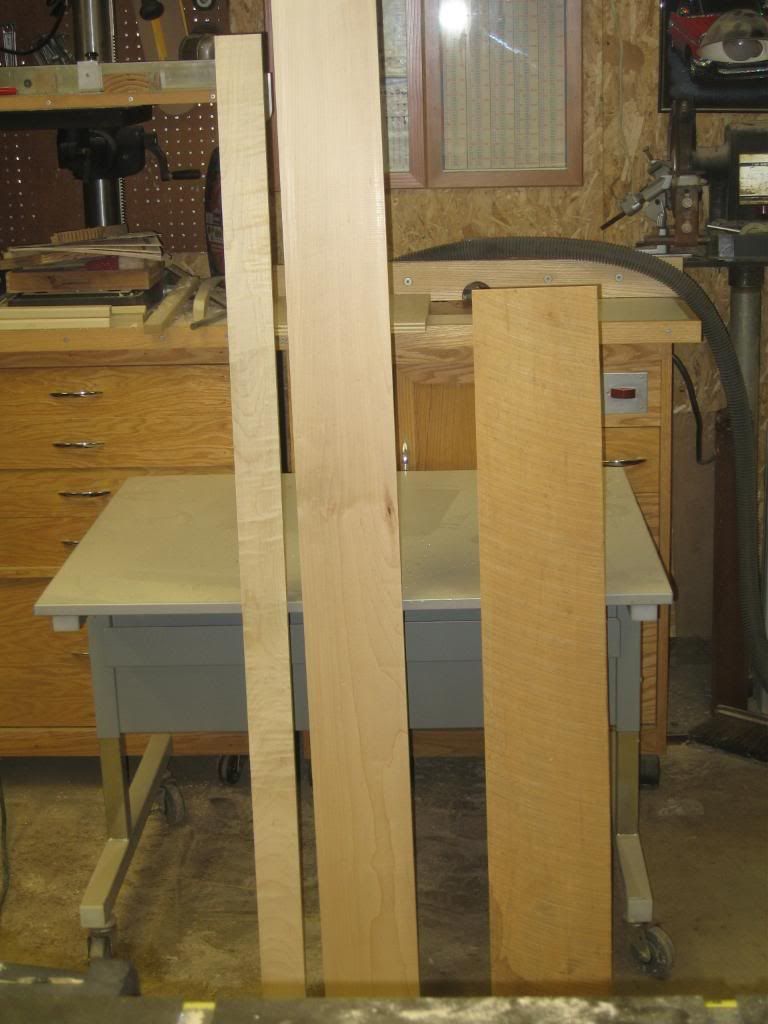

Thanks for the complements all. Yeah, more pics. to come, at the slow part now making the finger board, and cutting in the frets by hand. got cheep, found a nice piece of maple, and some wallnut for the markers, got to try this to see if I can do it, can't be that hard. The question is, what did they do before CNC machines? THink I got it figured out, we'll see again thanks :)
