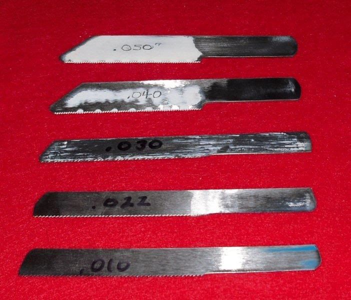

I wondered how could I make a set of nut files, when it hit me. Different width hacksaw, saws-all blades etc.
I got several blades from my junk drawer and started to grind and shape. Here are the first 5. I have them hanging right now with the liquid handle coating the end to make them safe to hold.
The hardest one obviously was the .010, but I started with a .025 hacksaw blade, and ground a little at a time and checked often. I used a table belt sander.
Here is a photo of the ground down blades.

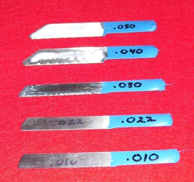

Postby panther » Fri May 20, 2011 12:52 pm
I ordered me a new set of the torch cleaners. The ones I have are from work, and kinds dirty.
Here is a photo of the coated handles.
