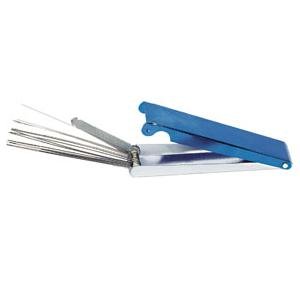

That's all I've been using for years to cut the slots then I use a torch tip cleaner to round out the bottom of the slot. They can be had for around $6.00 at Harbor Freight.

I've heard about using torch tip cleaners to round out the bottom.

dubtrub wrote:That's all I've been using for years to cut the slots then I use a torch tip cleaner to round out the bottom of the slot. They can be had for around $6.00 at Harbor Freight.
Neat trick! Thanks! 8-)

I ordered me a new set of the torch cleaners. The ones I have are from work, and kinds dirty.
