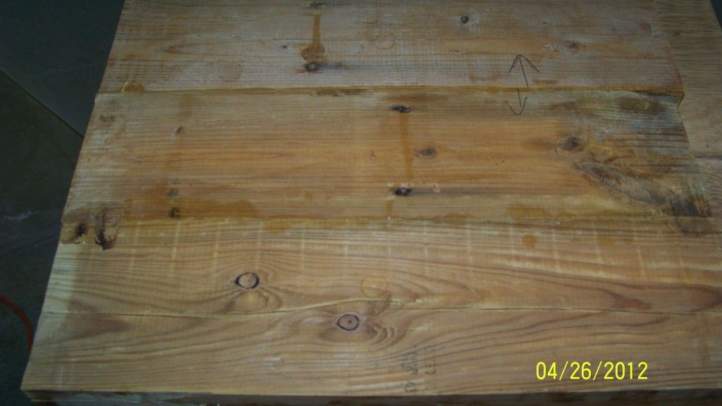

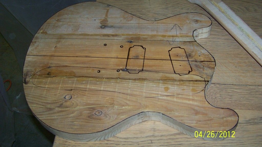

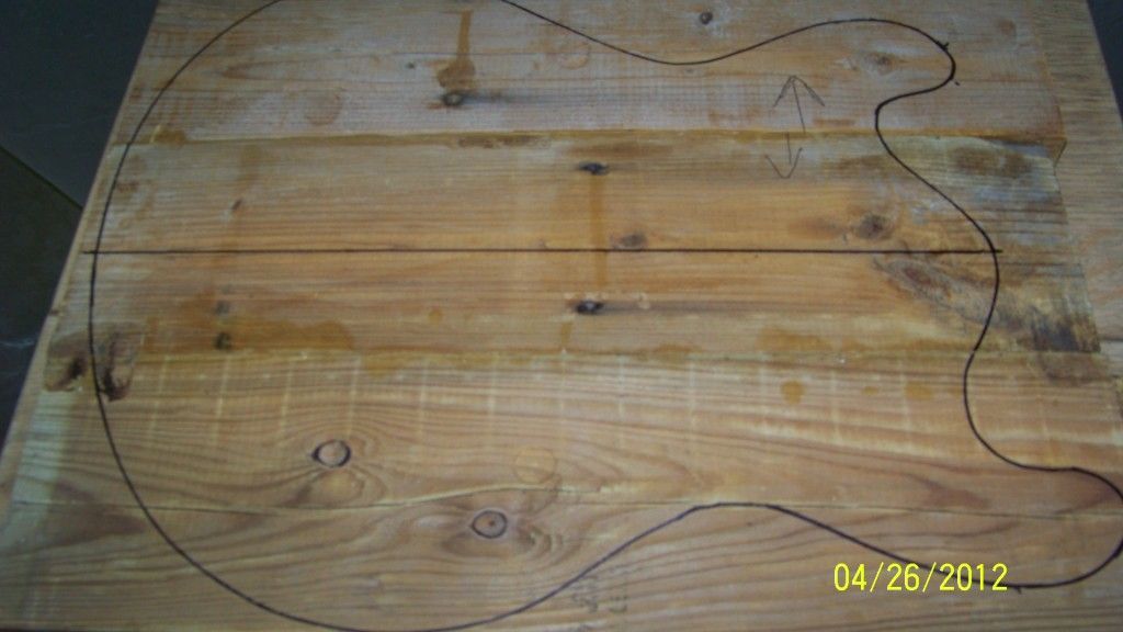

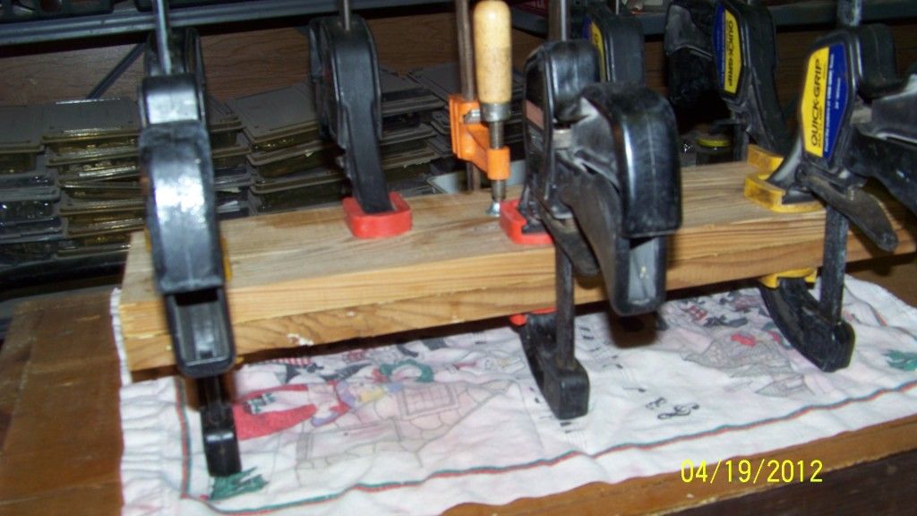

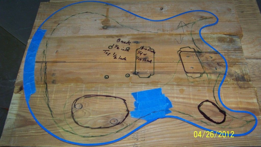

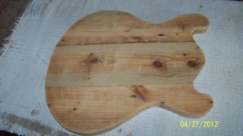

well this project has taken a slightly different turn. since I'm a sucker for free stuff, I brought in some old pine fence I had laying in my garage. it took a little time to glue up all the planks of wood, but so far, she's lookin good.

Don't I see a nasty crack running across the entire lower (upper?) treble side of the body?
Interesting choice of wood, though
Re: Joe Maphis/Combo build
yeah, that's why I choose for that side to be on the top. Since i'm constructing it based on the joe maphis, the inside will be hollowed out and then I will be gluing on the top wood. this wood may turn out to be a nightmare for a guitar body, but there's only one way to find out.

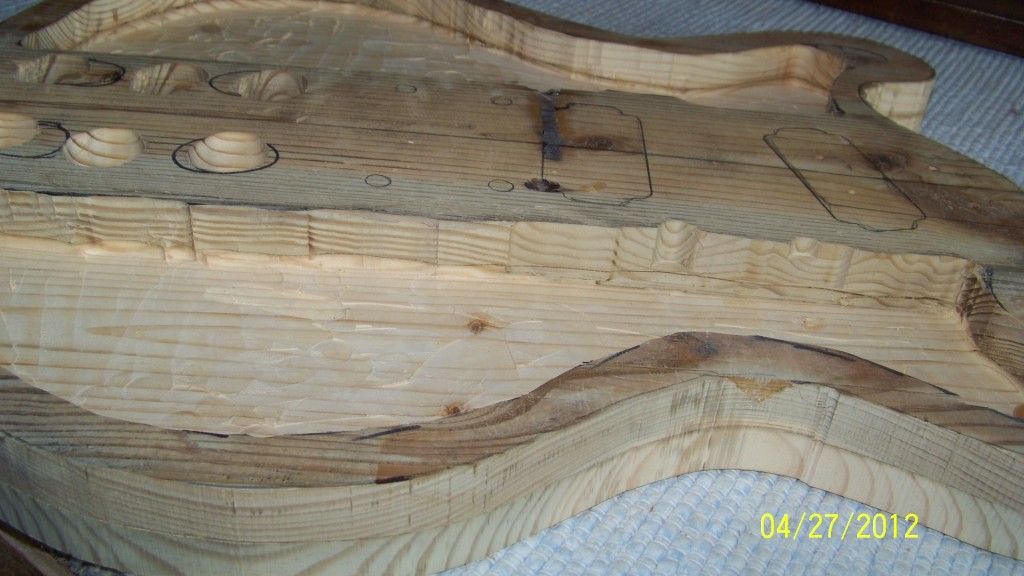

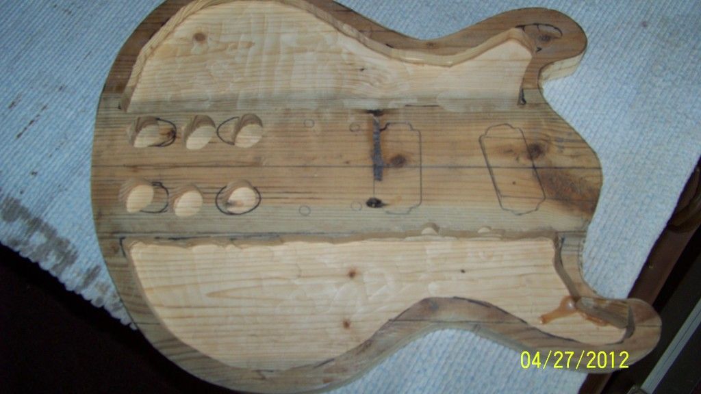

did some more work on this build. I hollowed out the inside using my router. I still need to go through it and clean it up some but here's what she looks like now.

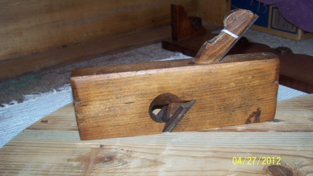

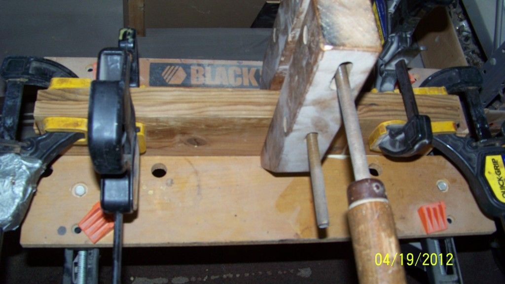

since these board had some warp in them, I had to plan out the top and bottom some. since I down have fancy equipment like guys like ED, I have to plan out the board by hand using this antique rabbit plane.

i cleaned up the routing job on this tonight. I'll post pics tomorrow. and I cut the top wood. gluing it up one section at a time. once that's don' t I can clean up the cut on the sides. I love the smell of fresh cut pine
