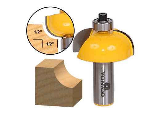

Community QUESTION: What do i do now? Next I was going to use a Large COVE bit around the edges to start my German curve. Should I try it fix this gouge now with epoxy or something or wait until after I do the cove bit? How do I repair this? Please comment :)

How much of the gouge will be removed when the cove bit and subsequent shaping is done?

Its a half inch radius.

I can't really tell how much of the chip will be removed by the time you have routed, rounded and shaped that area, but I imagine that it won't be all that much.
I'd use a mix of Titebond, CA or epoxy and sawdust (actually sanding dust) from the same wood source to make a filler.
