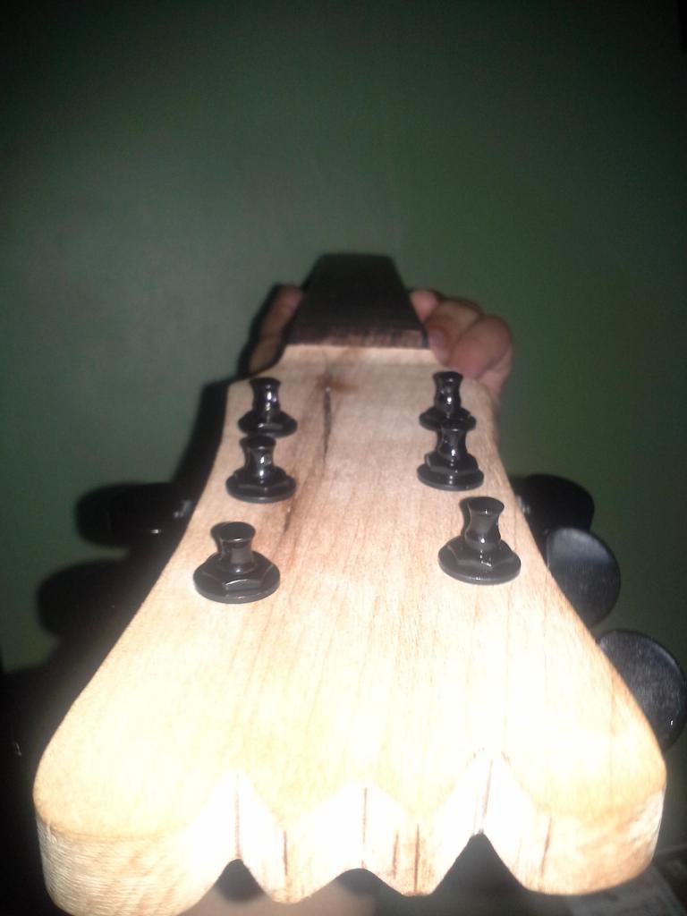

Ok. At this stage I can either shape the profile on the back of my neck or start putting in the frets. Either way I will have to deal with the Zero fret pretty soon. I dont see much discussion on this issue. I have leveled the fretboard but have not yet cut the string guide slot.
Do I install the zero fret the same as the other frets? Do I level the Zero when I level the rest, or just leave it alone so it is a little higher than the other frets? Do I even have to worry about it? Is the bow in the neck enough to make it clear the other frets so there is no buzzing?
I really don't know what to do at this critical step so experienced builders please help. What's you method? :?:
Also, when you shape the back of the neck do you generally shape the heel and volute first and then carve the middle, or the other way around?
Thanks!
