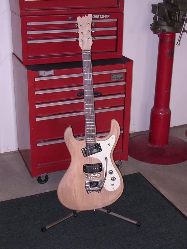

I started this project several months ago and had to put it on hold due to family member health crisis and have not yet started work on it again. Hopefully I can get re motivated before long.
This is a guitar that I built using templates I made from a 1966 Mosrite Ventures Model. Unfortunately I no longer have the guitar as I sold it to Desert Surfer. Creating the templates was just about as difficult as building the guitar as everything has to be precise. The good thing about a template is, I can make multiple guitars and the parts will inter change with each other. The bad thing is, why would anyone want to go to all that trouble just for a couple of guitars. My only answer is, I don't do anything the simple way.
For the neck I used curly maple, and for the body I used Alder. I cut the pickguard out of aged white pickguard material. The rosewood fret board and fretwire, I purchased blank materia from Stewart McDonald http://www.stewmac.com/ The pickups and vibrato are from Hallmark Guitars http://www.hallmarkguitars.com/ and the bridge is a Japanese Mosrite purchased from Zamminc http://stores.ebay.com/Zamm-Inc
As you can see, the guitar is still in the unfinished stage and hopefully it will be sunburst. Since I am building two of theses at the same time I will be finishing the second one in candy apple read with a clear natural finished neck.

Guitar is assembled in the rough form to make sure everything fit and was aligned up properly.
http://img.photobucket.com/albums/v305/ ... CN0242.jpg

Well, today I took advantage of some slack time and started working on one of the guitars. I cut all the fret slots, shaped the fret board and fitted the blank neck to the neck pocket of the body. This is the critical stuff and it really gets nerve racking trying to get everything to line up perfectly with the bridge, so that the 1st and 6th strings are in the right place on the neck. :shock:

One down, two more to go. I just wrapped up another one of my custom built guitars this evening. This one as you can see has tiger stripe maple neck, the body is Basswood, it's painted candy apple red using a white sealer, silver under base then topped with 12 coats of clear lacquer wet sanded between each coat, then hand polished to a high gloss finish. I had a heck of a time photographing this thing because the finish is like glass. Regardless of lighting and setting ( I'm not camera guru) I could not capture the candy apple effect on camera. It has Hallmark pickups, bridge and vibrato. The pickguard shows up as bright white but I cut it out of aged off white colored material.
BTW, this is not the guitar depicted in the first photograph of this topic, well the neck is but the body is diifferent. That body is on a sunburst one I'm building, it's Alder.
