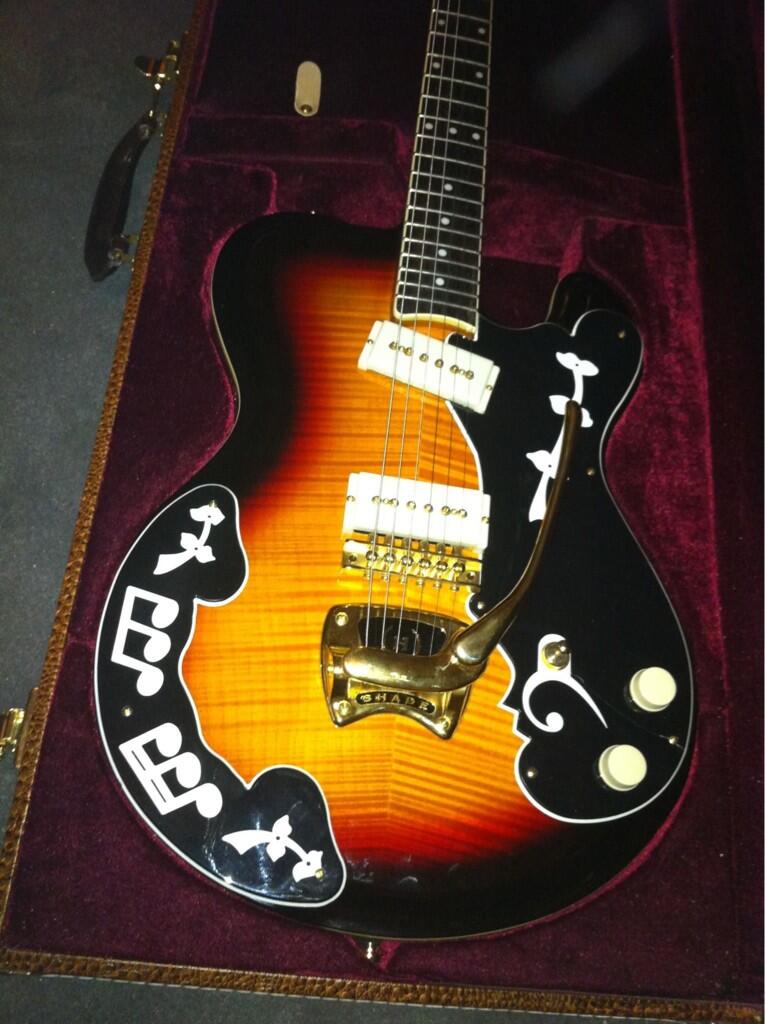

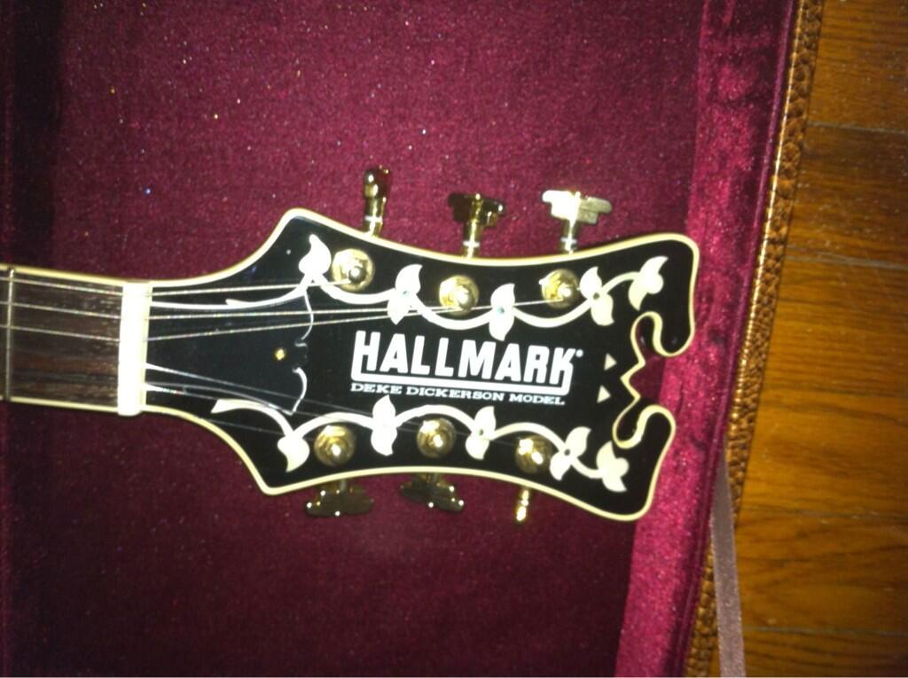

Fed Ex delivered my Deke earlier. Man is it gorgeous! It's in great shape, and if weren't for a cracked pick guard you would swear it was new. It's definitely lighter than the Deke I played last year. I think I prefer the black headstock.Classy!
One small problem though.....I heard something rattling in the guitar, in fact whatever it was was sliding around. I took off the pick guard and fished out the object. It was a magnet, part of one of t he pickups I suspect. Both the pickups seem to work, so I'm a bit confused. It looks,like the magnet(s) are on the rear pickup, but I can't tell about the front one.
I'm going to restring it this weekend, when I do I'll look, at the pickup. I guess I can just replace the magnet???

You want to make sure it goes back in with the correct magnetic orientation. With both pickups activated, if the tone is thin and nasal, they're out of phase, and you'll have to flip one of the magnets around. Those pickups are clones of Carvin AP-6's from the '50's and '60's, and those were pretty crudely constructed--I don't know if the Deke pickups are any better. They sure sound great, though--one of my former guitar students had a Deke model, and it was really nice. I made him promise that if he ever wanted to sell it he'd give me first crack at it, and he went and sold it to someone else!

Awesome, yeah, I thought it'd be an easy fix.
Here's some pics!
Here's some pics!

Yes it simply need to be glued back in place with the south side toward the pole pieces. This happens every now and then during shipping because the pickups are exactly made like the vintage models. The mags are simply glued to the coil.
Epoxy works well.

It looks like the shipping box took a bit of a hit, so I suspect that's what caused it.
