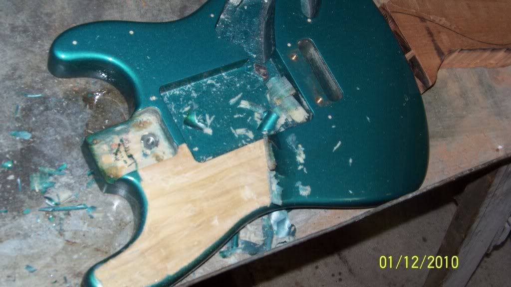

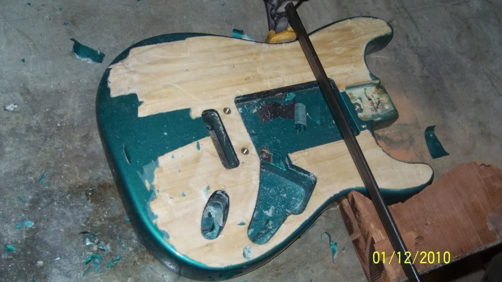

Agree with Adam - no checking on the finish implies it is a refin, or poly. As was mentioned, you could test the paint in a pocket by swabbing it with acetone (nail polish remover) - if it comes off on the swab, it's likely nitro. Poly is impervious to all but nuclear blasts (if you've ever had to strip it) ...

a little off topic here but, to remove a poly finish use a heat gun. heat up the finish then carefully remove it with a metal scrapper. Be careful not to scorch the wood. It's not fun, but it's the easiest way to do it. little trick I picked up from Danny. By the way, thanks Danny you saved me A LOT of time in my shop with that advice.

...also a little off topic here but Aaron, I can't help thinking what was the matter with that strat body...(it seemed OK) or did the owner simply want another colour?

+1 on the heat gun, if you're unfortunate enough to have to strip a poly body. Unless you're into self-flagellation - then enjoy the experience ...

the first poly finish I tried to strip was by sanding it. BIG MISTAKE. The only thing it accomplishes is a dirty and dusty workshop. Using the heat gun works far better. if someone wants to tries this, you want to watch out for not digging your knife into the wood of the guitar body and splittering the wood. poly is so hard, it's easy to want to try too hard to scrap off the old paint. also, very simply, be careful not to burn yourself! it can happen doing this, even when you are careful.
To answer your question Paul, yeah there was nothing wrong with the finish, he just wanted to refinish his old strat with nitro because he liked the feel better. so while stripping it he also said make it Olympic White. Something about a Jimi Hendrix feel.

The first one I did, I used Bix stripper, and lots of scraping and sanding. What a nightmare! Lacquer just washes off under Acetone - mucho mejor!
