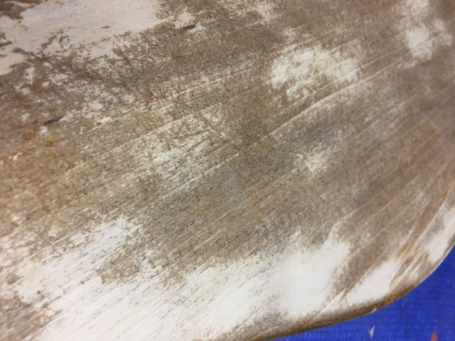

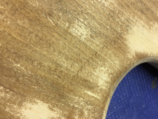

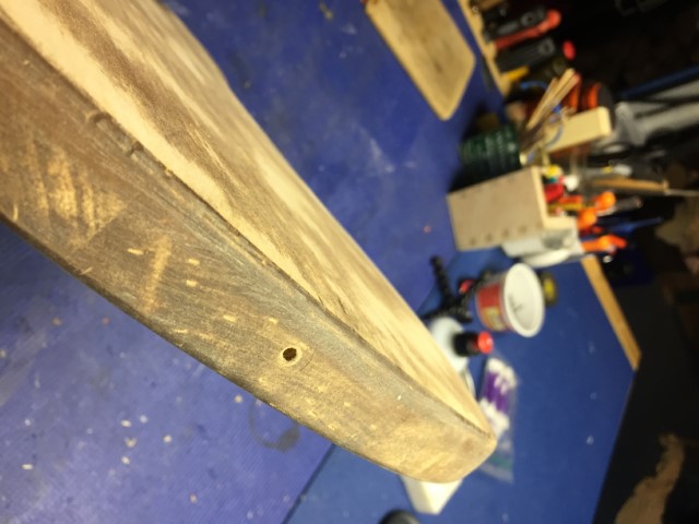

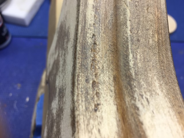

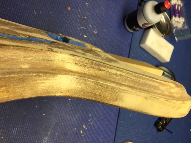

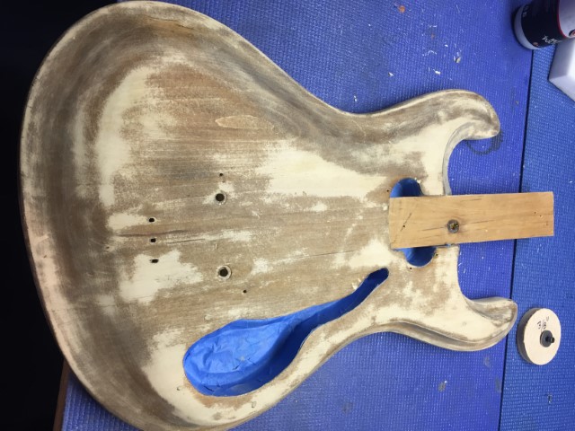

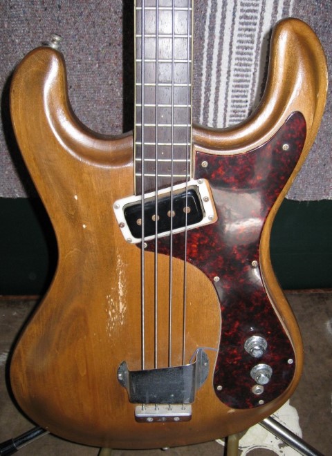

Now, before it came to me the poor thing had been refin'd in "natural", which I now know to be an absolute not-original-Mosrite configuration, but one that for whatever reason it seems like a number of morons thought was a good idea for poor Mosrites in the 1970's and 1980's... So I started tearing it down and discovered that I'd really never probably ever taken a hard look at it.
The poor thing was a mess. Immediately in the control cavity it was clear the instrument had been a creamy white. But torched areas in the neck/pickup pocket and control cavity showed signs of a heat gun used with extreme predjudice. Rotary sander scuff marks all over the flat sections. Gouges from a screwdriver or pick or something used to scrape paint from inside the deep carves. The finish was some awful urethane probably but (if you can believe this because its almost always the opposite...) applied way too thin, so the body was gouged up and belt-rashed deeply and just dinged all over the place because the finish provided less protection than a shellac'd violin. Not only that but despite the inadequate finish, they STILL were able to get runs in it so the back and front both had a good number of drips. On top of that a crack was developing just on the lower-bout side of the neck pocket that needed to be addressed, probably from being banged around all these years and having who knows what piled on in in what kind of conditions.

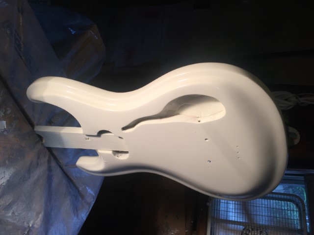

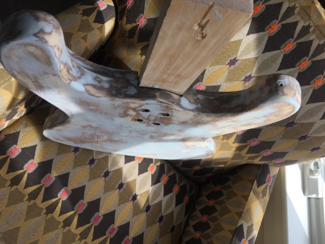

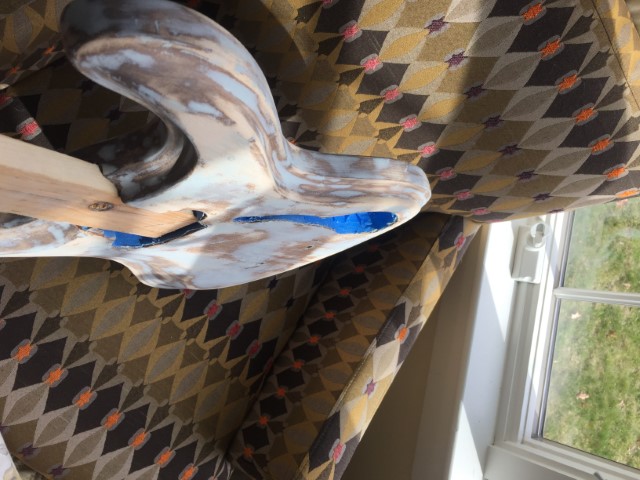

So I foolishly started in on the refin about 6 months ago, thinking "oh this is such a beater, it'll be a good practice for a guitar refinish... and I won't really care how it comes out... probably just take me a couple weekends..." Ha. That's a riot. 6 months later and many many days of work...

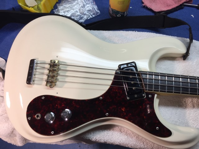

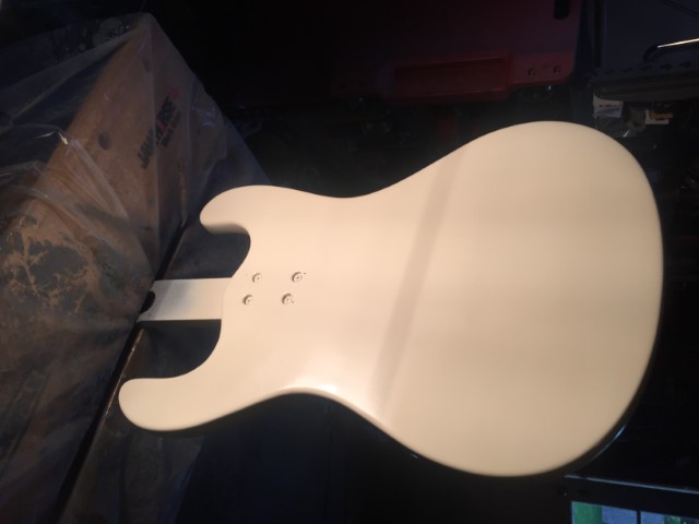

She's a finished. Came out great but only after many iterations of filler/sanding and paint/sand-back/re-paint. Much rework done due to my n00bitude for sure, and failures in technique and setup. In the end I am really pleased however in how she came out. There's flaws for sure but in the acceptable range, and you have to look super close to find them. As i said to Bob Shade in an email today - "I was shooting for a 20-footer but I think I got a 5-footer, maybe even a 3-footer!"
Speaking of whom, during the work, the stock pickup turned out to be all rotten and corroded inside... it sorta kinda slightly worked but not properly and didn't read any resistance on a meter (a classic old-pickup-with-broken-coils-capacitive-coupling I suspect...) so that went off to Bob for a rewind. He did an amazing job and the instrument sounds fantastic. He also provided me with the one real vintage part I needed - a NOS pickup ring. I did also shield the cavity - something Semie never bothered with it seemed - and between that and a solid bridge ground, the instrument is really nice and quiet too! Bob's just a really good guy and super super helpful, encouraged me to call him up with any questions or anything I needed, absolutely would recommend him to anybody who needs parts and help with these instruments...
The only non-stock item on the instrument - pickup windings not counting - are the tuners which sadly had been bored out and replaced by too-large Schallers long before I got the thing (probably same time the horrible refin was done...) The old nitro pickguard is original and was in good shape except had done the classic nitro pringle-chip warp thing, so I gently baked that between a couple of polished marble tiles and then took it out stacked a weight on the sandwich for a few months while the paint was being applied, sanded back off, reapplied, etc. etc. and then the lacquer was drying and then was being polished, then drying some more, etc....
On to the pictures. Here's a progression of pix I happen to have grabbed here and there, although many many steps missing in the middle.
