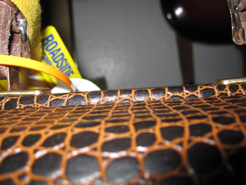

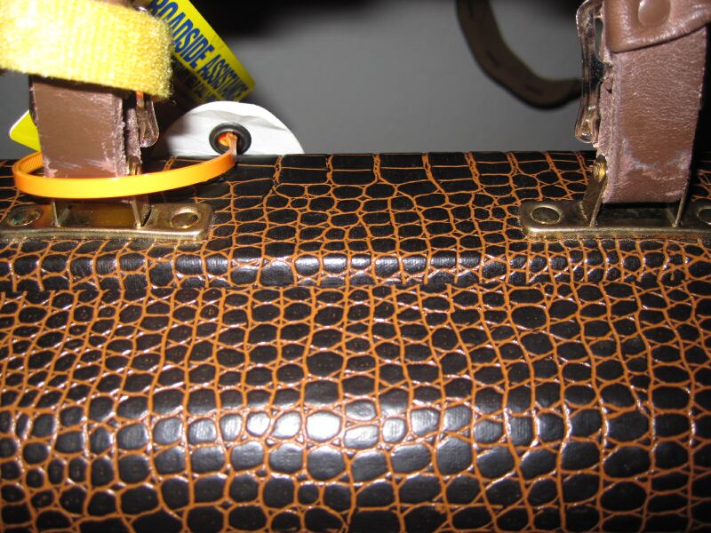

I finally discovered the cause of the mystery Hallmark TKL case squeaks. Turns out that is wasn't the handle at all - it was the case itself! With a guitar in the case, lifting the case by the handle actually warps the wood under it, causing the squeaks.
Here you can see how much the case warped:

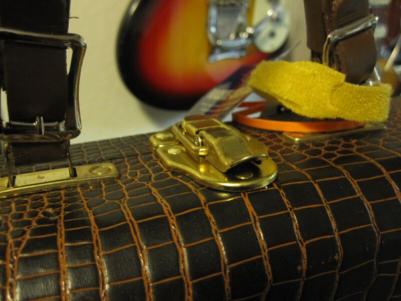

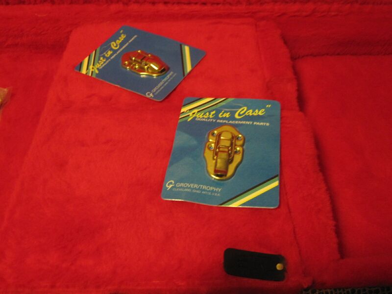

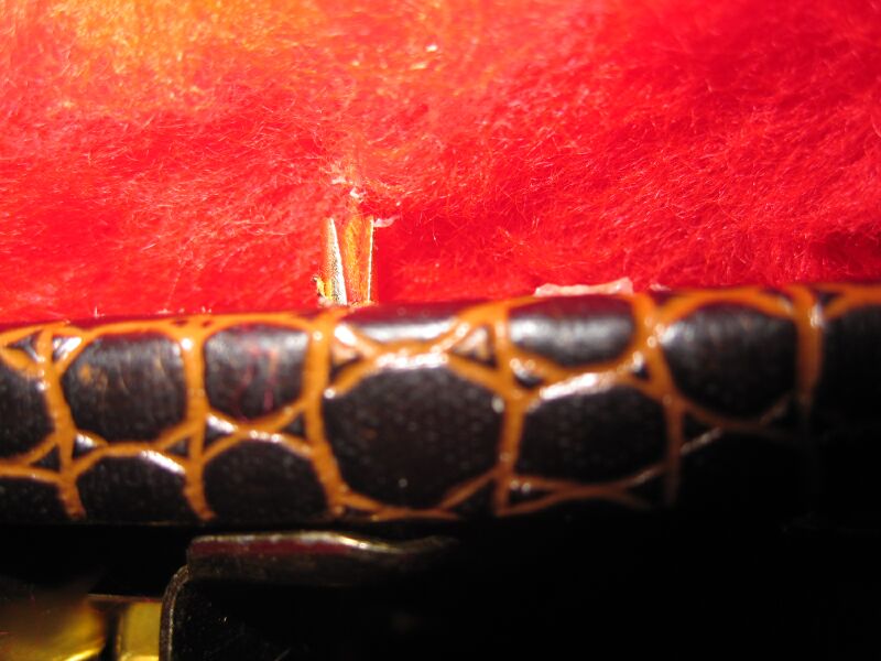

As a solution, I decided to add another case latch. After a bit of searching, I was able to find the same kind of latches as the originals.

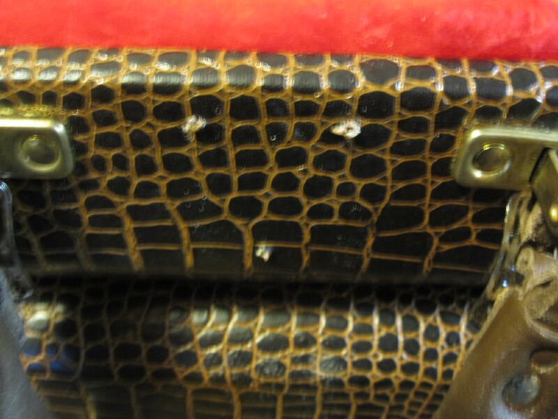

I aligned the latch in the center of the handle and drilled the mounting holes.

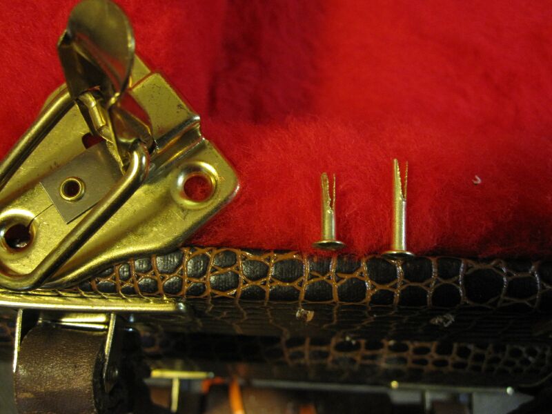

The latches are attached with finishing rivets. I found them in two sizes 1/8" and 1/4" inch. I used the 1/4" ones.
The rivet sticks through just enough for the split tangs to stick through. I used pliers to bend them down. It's important to make sure the rivet head is flush with the latch when you bend them so they are tight.

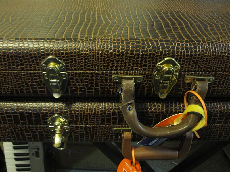

Here's the finished installation, sitting above my other Hallmark case, which, for whatever reason, hasn't had this issue.
Now, with guitar in case, there's no warping, and no squeaking!

Ha! My old Buick has so many weird rattles I've come to find it charming (granted the 350 V-8 helps, too) :D With a guitar case, there were only so many things that could be squeaking, and it was a particularly unpleasant squeak at that. I can't believe it took me so long to figure out what it was. Of course, looking straight down at the case while holding it, you couldn't see the warp. It was only when I put the case on my workbench *with a guitar in it* that I actually saw the warpage.
